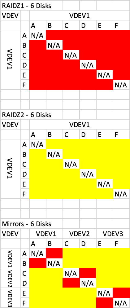

What you will be adding is a risk that 2 disks failing will kill your entire pool (not the case with RAIDZ2)... see below, Red is Pool loss, Yellow is Degraded.

Hey, thanks a lot! In light of your graphic I'm reconsidering upgrade path. To make sure I understand, basically with mirror vdev if the wrong 2 disks (disk1 in mirror1, disk1 in mirror2) fail then pool is toast, in order to have the similar safety as RAIDZ2 would need triple mirror?
Since my current chassis only supports 8-bay I'm considering upgrading the RAIDZ2 instead... wouldn't be possible to have a 3-3-3 mirror without adding more bays. In this case I replace each drive individually, resilver, when all drives in pool are replaced with larger capacity I can expand pool size?
With 8 bays, 6 of which are used, you may even replace one or two drives at a time, leaving the old drives in place so you have full redundancy all along. Only remove the old drive(s) when resilver if complete.
If the right flag is set, which should be the case by default, the pool will automatically register the larger capacity upon replacing the 6th drive.
