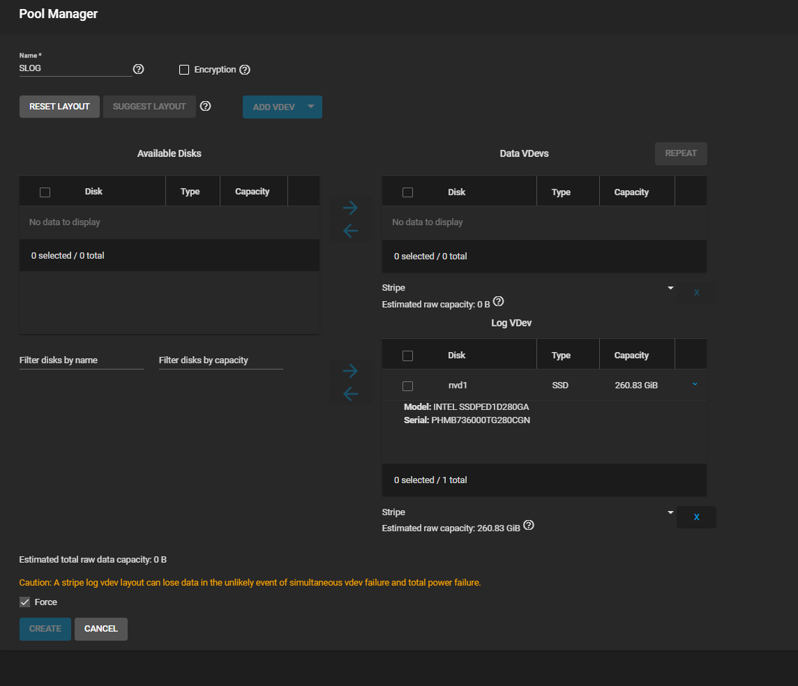

So I received the Optane 900P today. Popped it in the system and all is good. However when creating the VDEV for Slog it gives me the warning that it is not in a mirror configuration, which is fine. It gives you the option to acknowledge that and to force the creation of the pool. However when I agree to the warning and continue, the "Create" button remains greyed out and I cannot continue. Something I am missing ?
Thanks guys.
NugentS
Apr 16, 2020
2,947
Shouldn't you be adding it to a pool, not creating its own pool
