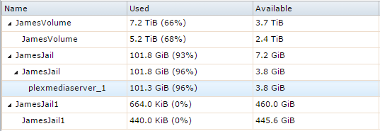

Hey guys, im a noob at freenas, i using freenas as a plex server, i have my storage on a different drive than my Jail, plex has filled my SSD and i have a new one that i can put it on, is there a way to migrate the jail to my new drive?

Zfs replications would probably be the best solution. Create new pool with new drive and replicate the data over then change your jail path in the GUI.

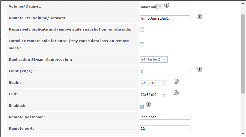

Based on what you see here, are the settings correct?

Hello, i started the replication task and got this error in the status section.

uh....is the new disk actually mounted on /JamesJail1?
You do understand the concept of mount points right?

pirateghost, thanks for your responce, i had it like that because while i was making it, its says to not make it mount point, but zfs volume and dataset. is this not right?
and yes, the new drive is mounted as /JamesJail1
I dont understand what you have right now. Based on what you have stated, it sounds like you tried replicating to your boot.
what exactly do your volumes look like?
what mount points do you have?

i actually attached a capture of my storage on the very first post, my set up is freenas on a usb, with 4x3tb in raidz, a 120gb ssd for my jail, and a replacement 500gb ssd for my jail, storage is labeled as JamesVolume, Jails are labeled as JamesJail, and the new jail drive is JamesJail1

just as an FYI, you don't need a new storage point for your jail. I am finally on a computer and could see your storage screenshot.
you can create a zfs dataset on your storage (something like plexLibrary), and add a storage mount to your jail to it, move all your library over to it, and then mount it as the library. I don't store my library within the jail, I leave it in a dataset and mount the storage point.

you can keep the jail on the separate drive and just store the data from plex on a dataset....you are wasting SSD for nothing.
