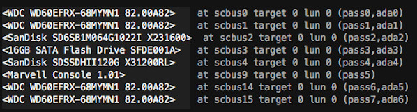

I have not created a pool based on LUN before, but you can see the LUN number by using camcontrol devlist and the output looks similar to this:
