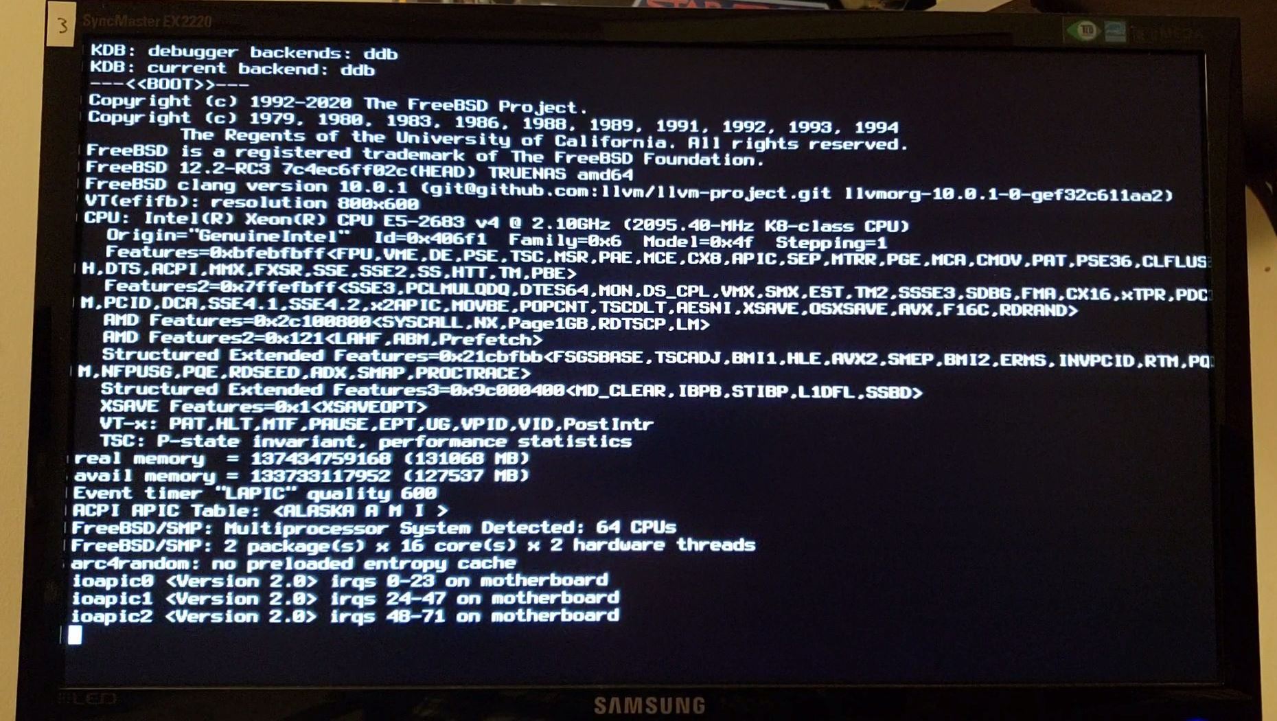

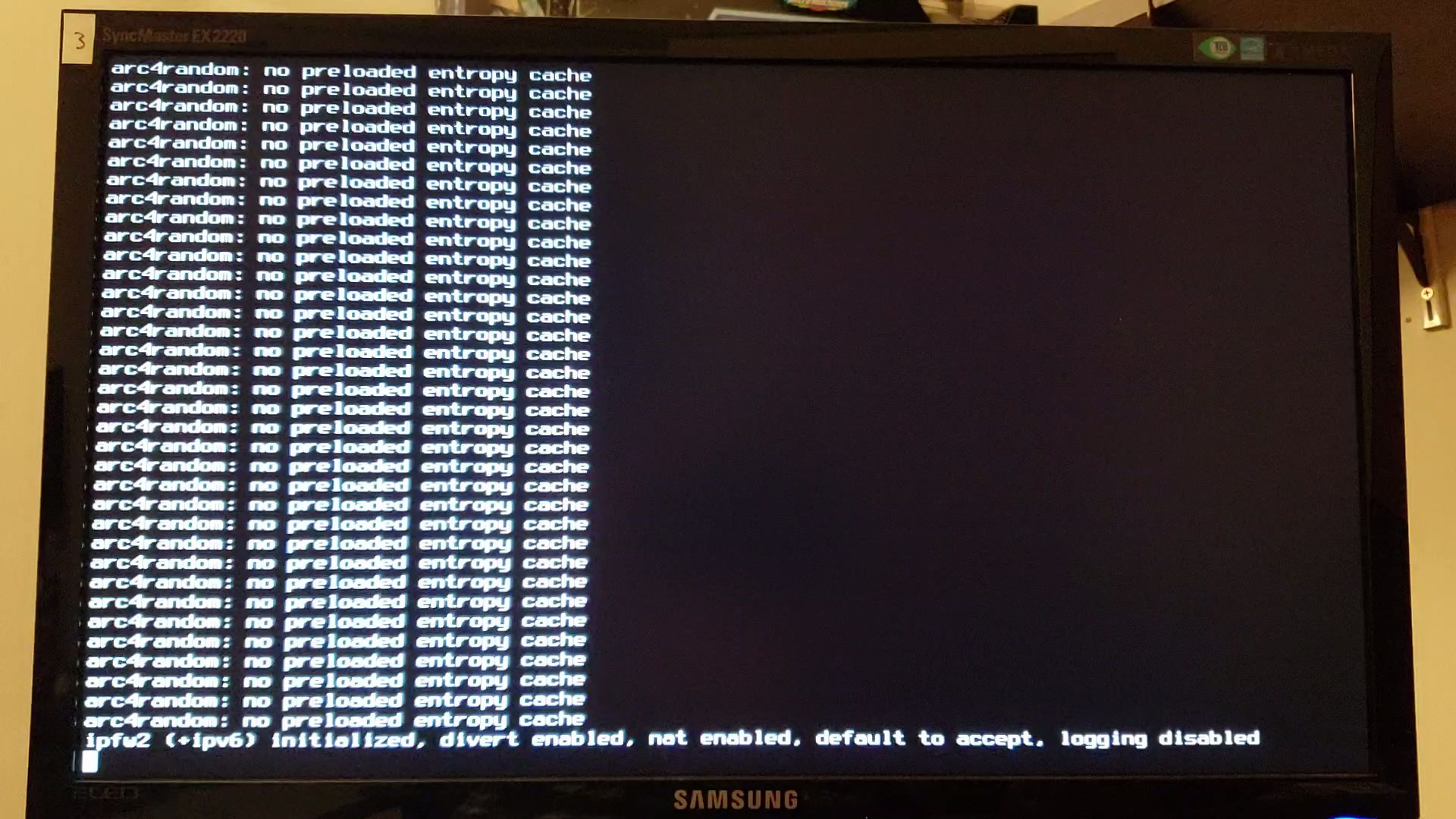

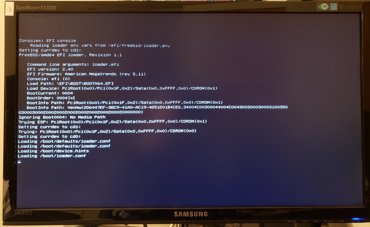

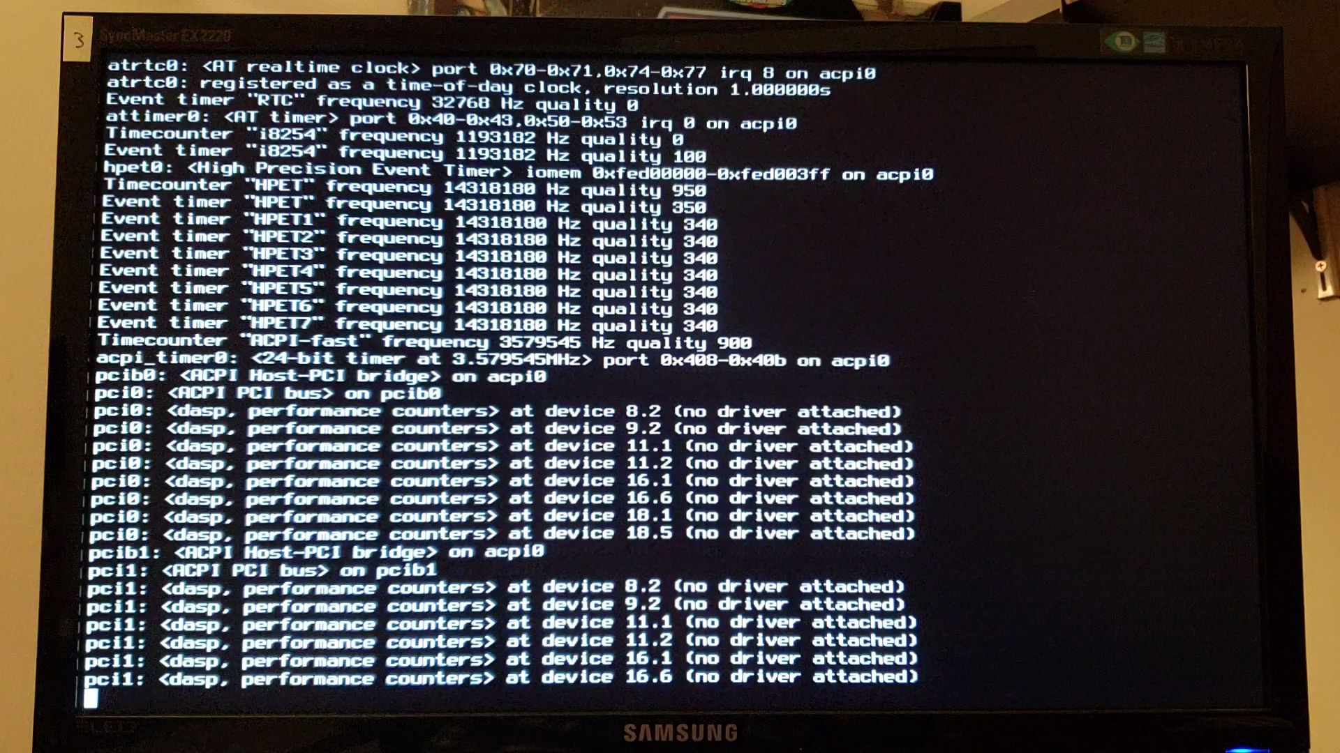

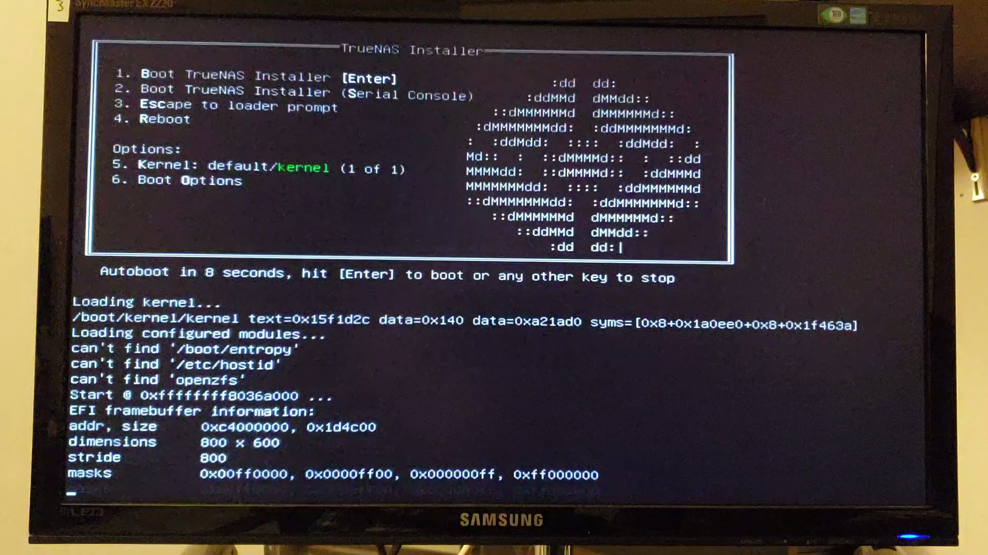

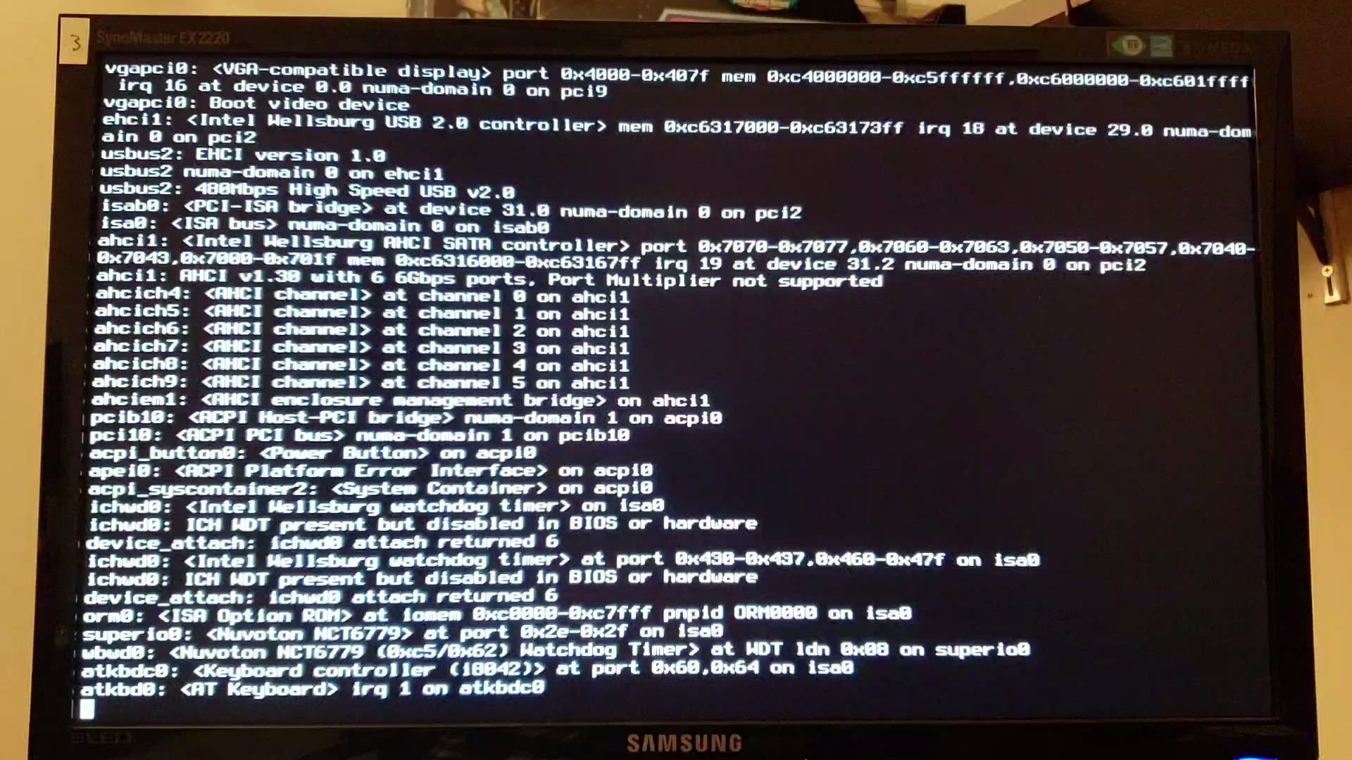

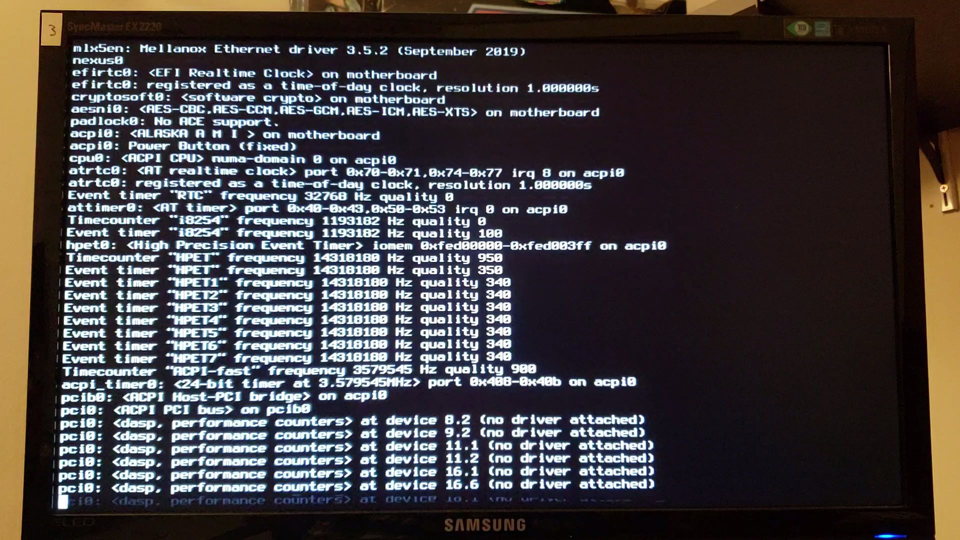

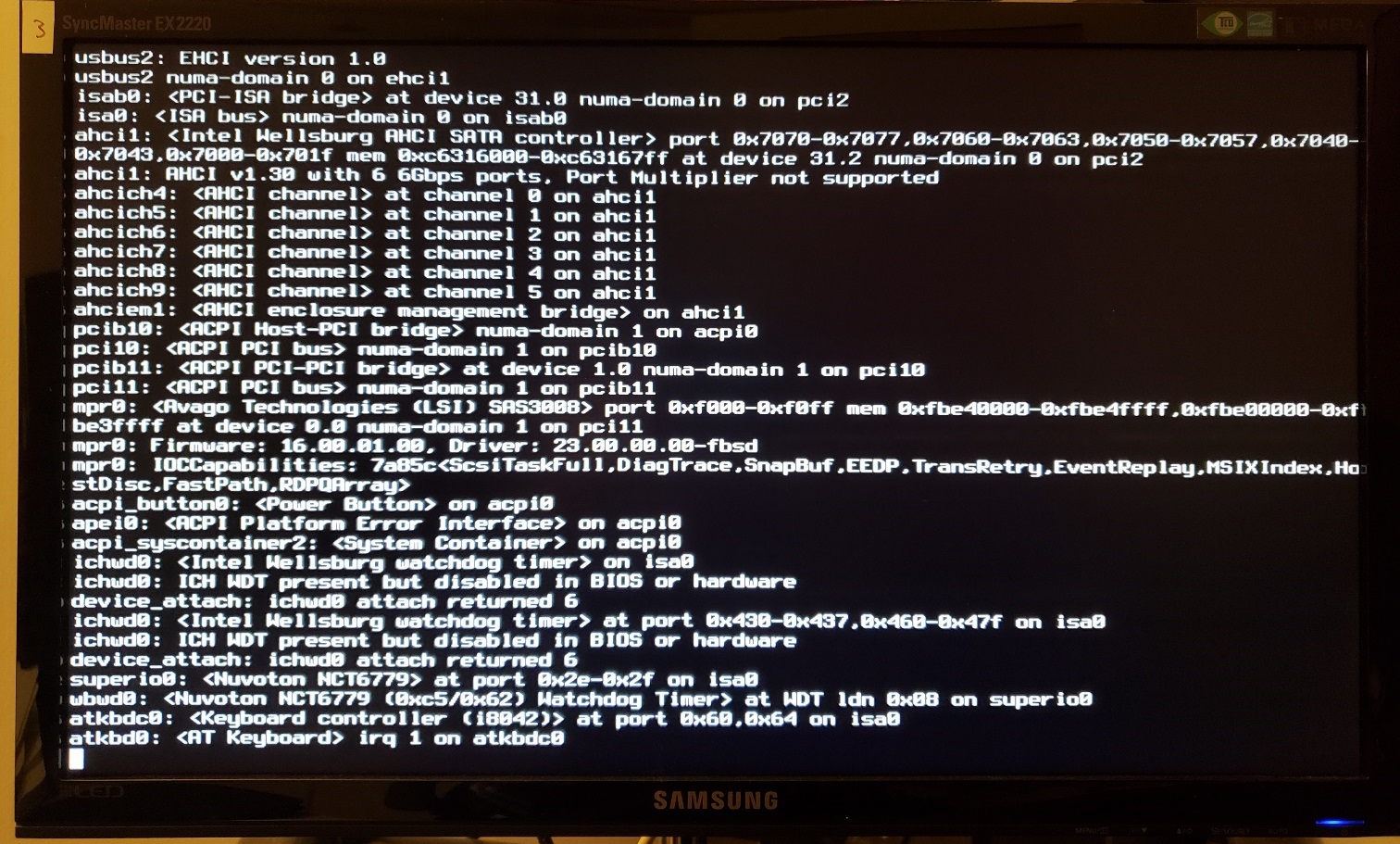

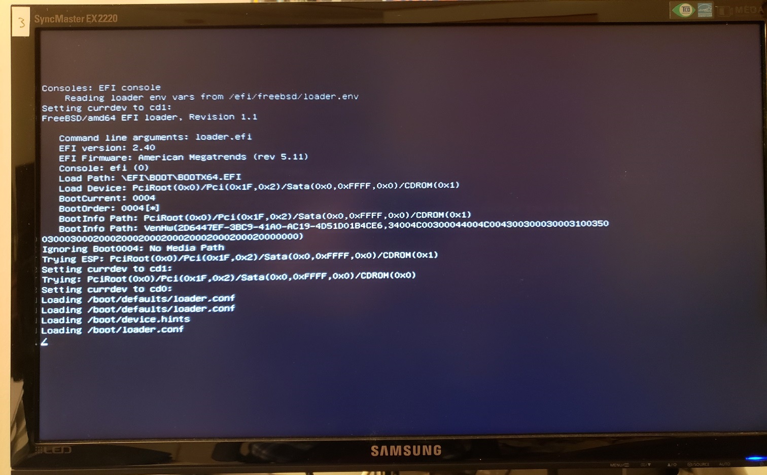

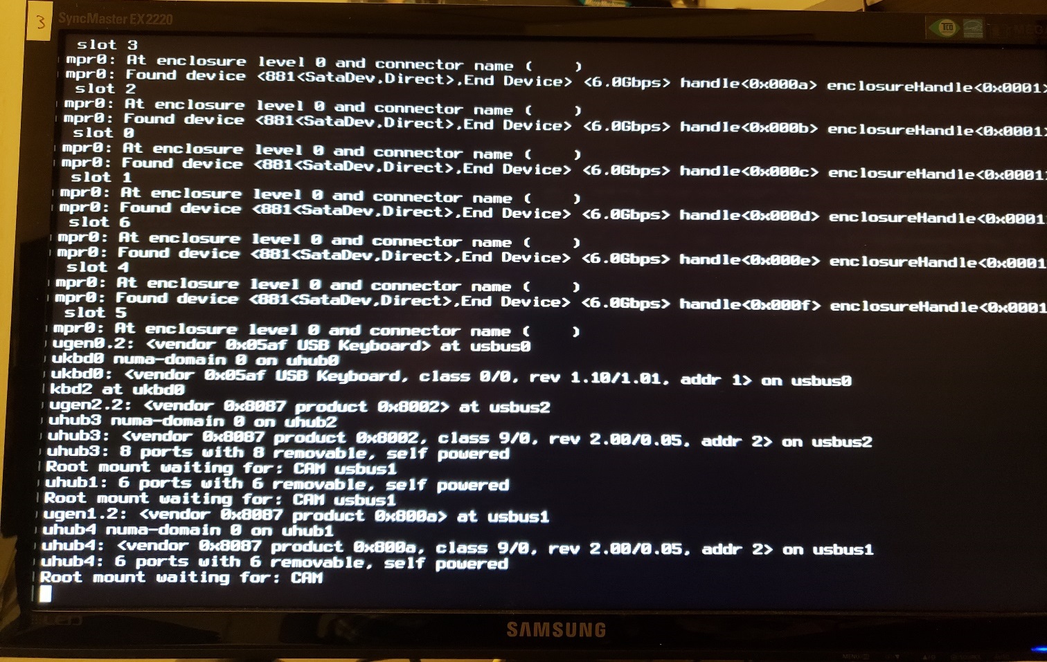

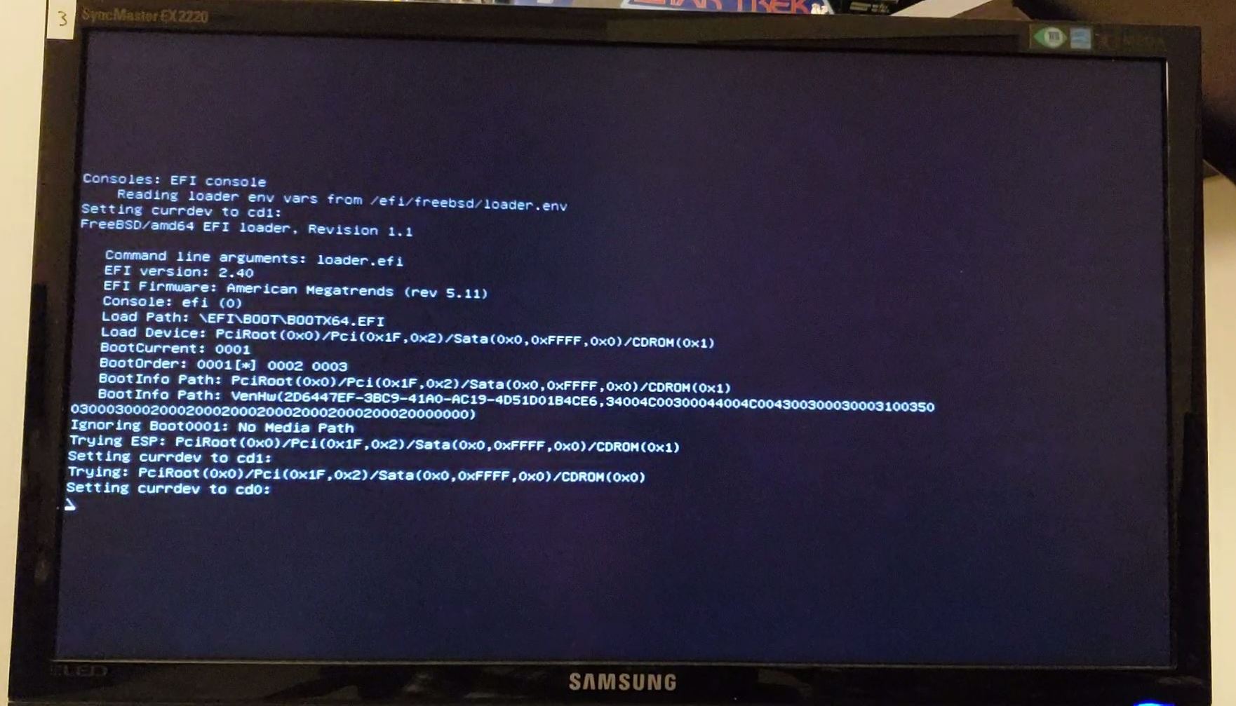

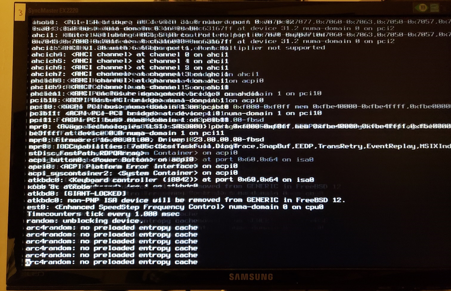

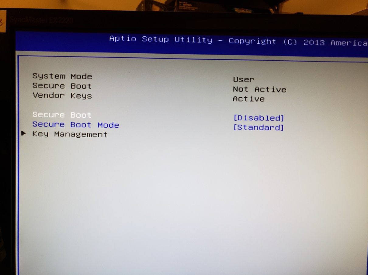

I have run out ideas to test. I am trying to do a new install of TrueNAS 12.0-Release onto a NVMe drive. I have tried multiple usb drives (and iso writers) and now a via DVD. I tried UEFI and legacy bios settings, I set the install device to the 1st boot option, network boot is disabled. Secure boot is disabled as far as I understand (see attached). It will show the boot screen and load the kernel but then it simply reboots without reaching the install screen. It does that in a loop. I was able to install Ubuntu 14.04 and Windows 7 with no issue. I was also able to install TrueNAS on a VM in Ubuntu. I am not seeing any errors. It just reboots without warning. I also tried removing all devices (HBA and drives, NVMe drive) and using a HDD but the same issue occurs. I also tried other versions for TrueNAS and FreeNAS, same problem.

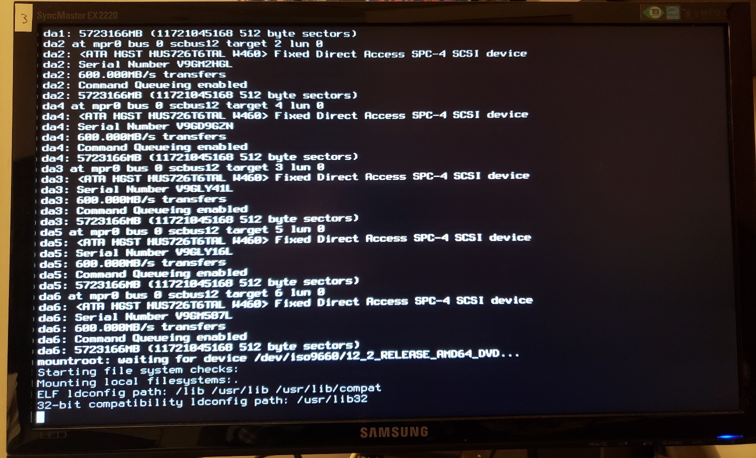

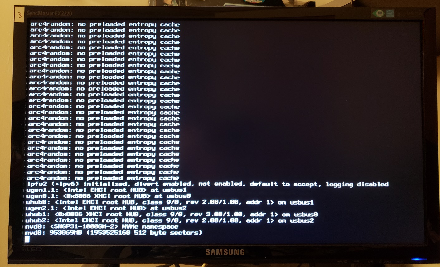

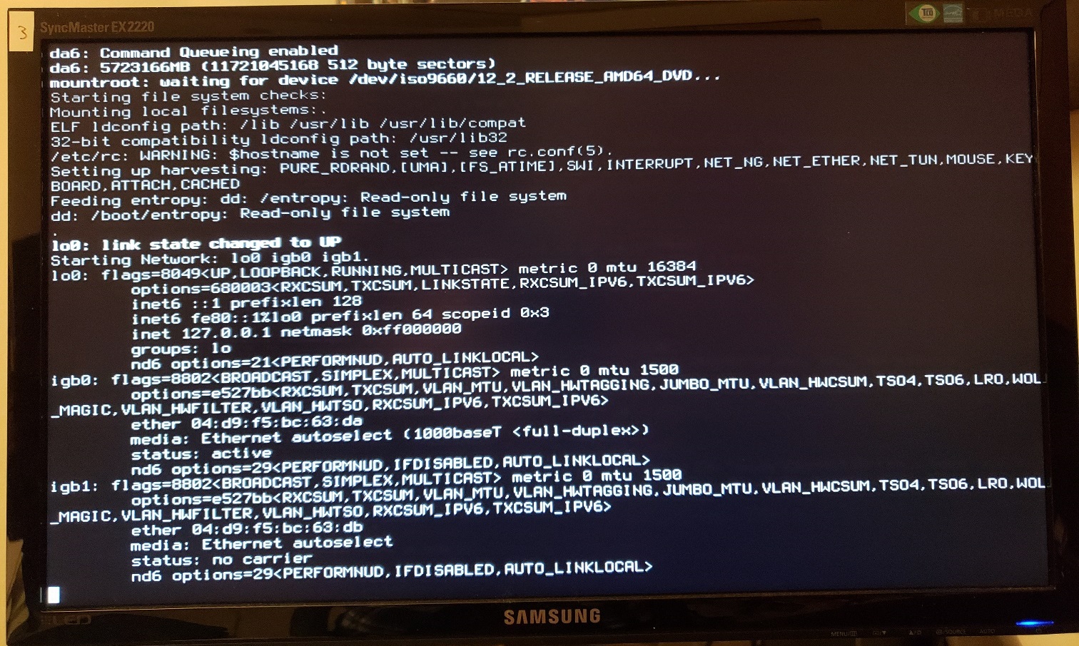

The regular install seems to stop at the same point (attached: install_6 or install_7 with NVMe installed). Attached pictures are only for the regular install (not VM).
If I could get some insight as to where to look next, I would appreciate it.
