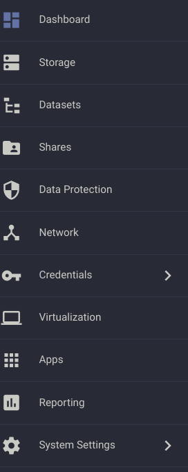

I changed after reading some posts and decided to install SCALE instead...
The install went clean and is up and running. However, no plugin in the menu ?
