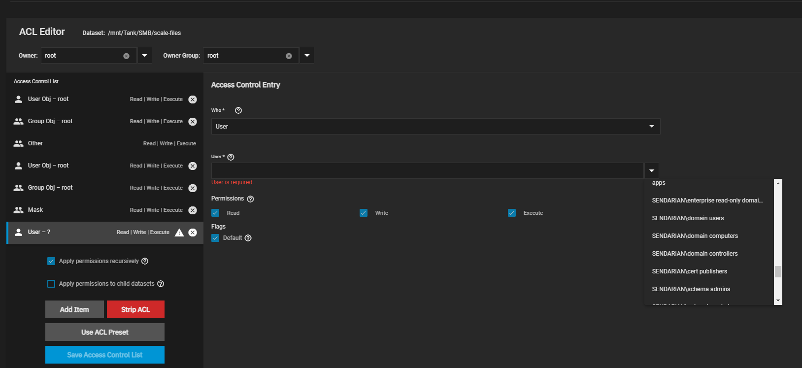

  15. Edit permissions on scale-files. Attempt to add group domain users from domain - not present. There is a list of local users, but no domain users. Typing in "DOMAIN/domain users" generates an error (name not found)

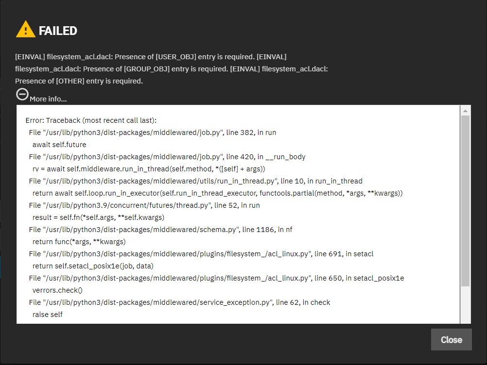

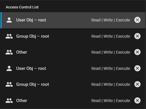

  4. Choose Set ACL, Select preset POSIX_Open (no idea what this means) - but choosing any of the others doesn't seem to make a difference
  5. There seems be some duplication here
  6. Remove duplicated entries and save - operation failed

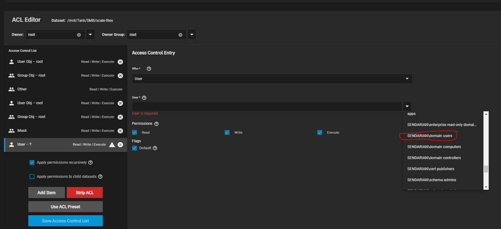

Creating a dataset and adding permission to it. It seems to want a mask - so I add one
The I try to add DOMAIN/domain users but the group isn't available. Some groups are, but others are not. I also have a user included in the list of groups for some reason that makes no sense
Also the user group Domain/domain users is now included in the list as a User as are a bunch of other users
But this is not consistently wrong, so its not as if groups and users are switched. Some users are in groups and some groups are in users
I have to conclude that in this BETA AD Integration seems badly borked.
