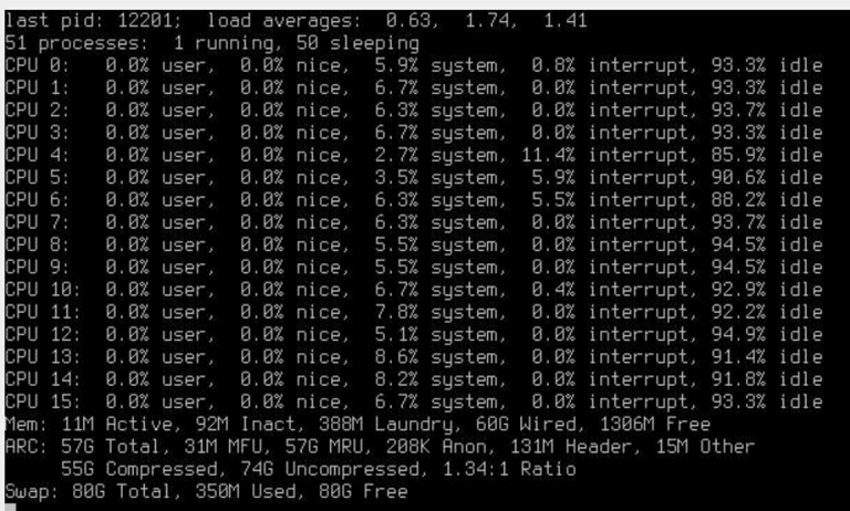

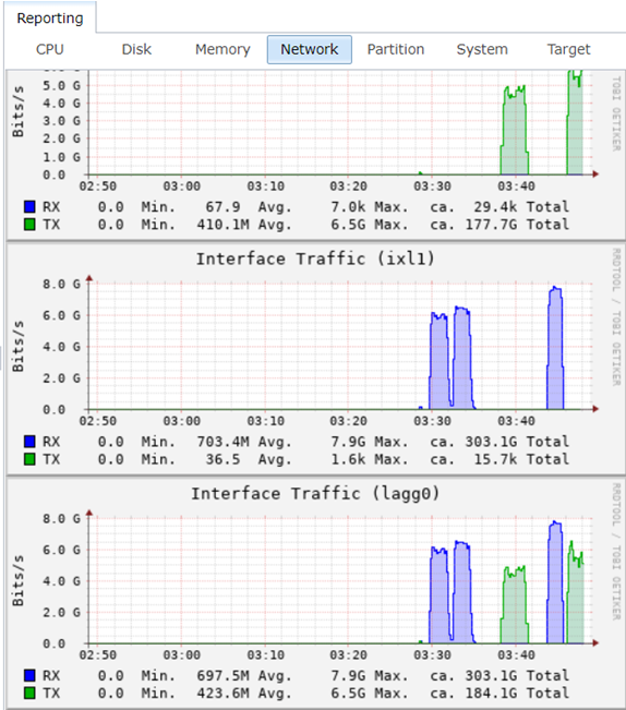

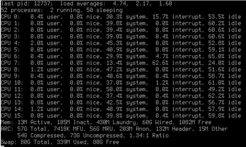

Minxster
Sep 27, 2013
36
I've been off grid for a while, still trying to get my head around things.
Compression - this has only been left off during DD testing just to see how the drivers perform overall. This was just to see if the system as ok in general or not. However, during real-world testing I've been turning it on after resetting the dataset.
... I did say I would re-install with 9.x but this failed as the NIC drivers weren't available during that version, so I had no way to control the system at all. So I just put back v11.
CPU - now this is where things could get interesting, the the CPU will Turbo Boost to 3ghz!? https://ark.intel.com/products/123544/Intel-Xeon-Silver-4108-Processor-11M-Cache-1_80-GHz - how do I check for boost?

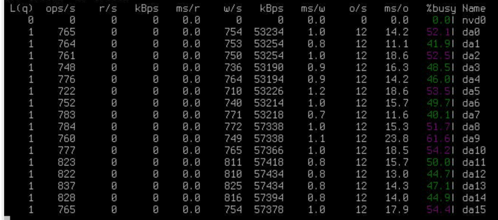

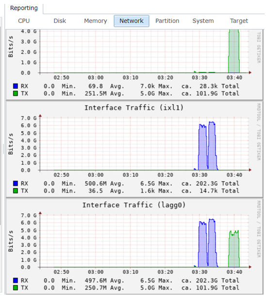

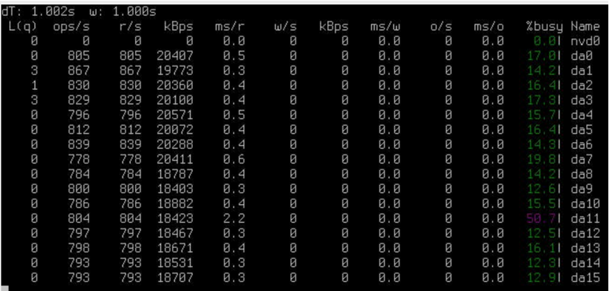

I did some testing using a 2 x Z2 arrays (8 disks in each). I've attached a screenshot of a real-world transfer of a 104gb file over iSCSI ("104gb file - iSCSI.png") - the file was transferred from a workstation using an M.2 drive, you'll see the the CPUs are not being hit hard at all, these numbers stay
pretty consistent. Disk utilisation did seem very high though ("104gb file - iSCSI - HDDs.png") which was a little odd.

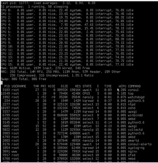

This next test was reading it back to the M.2 over iSCSI... "104gb - transfer back to M2 - HDD info.png" and "104gb - transfer back to M2 - CPU info.png"... I even took a screenshot of the LAGG NICs (2 x 10GBe) "104gb - transfer back to M2 - NIC info.png", you can see we did 2 x write and 1 x read tests. The read is so much slower! FYI, we get the same sort of stuff when using single NIC/port and we've tried to just swap the cables incase there was a cable issue.
We then tested again, using a fresh CIFS/SMB. "104gb file - SMB - CPU info.png" - you can see that one core is around 60%, but that's really about it and while watching it "live" it did really shift up much more overall.
I'd have thought, with overall spec of the system that a CPU issue would have seen a single core being maxed out during these tests? The whole system gets way worse if we transfer over lots of 4mb files (DNG files) over either iSCSI or SMB, but the CPU still remains the same. I've attached a screenshot of the NIC during the SMB testing "104gb file - SMB - NIC info.png", we only did one write and one read, so it's the last two peaks on the graphs.
So I'm still missing something: reads are still slowing than writes, CPU is not really being stressed especially during the reads so I can't say for sure it's a CPU issues at all.... How can I tell if Turbo Boost is working and/or how I can I enable it?

Minxster
Sep 27, 2013
36
Thanks rvassar, getting anything like 7.8GB/sec would be nice, we're getting around 7Gbits according to the NIC graph, so less than 1GB.
... This takes me back to one of my early posts about this; by using the DD commend, the read was miles slower than the write and when running in a striped mirror it just all but fell over. I would have thought the UPI/PCIe bottlenecks wouldn't be an issue just now given the strange write vs. read symptoms?
