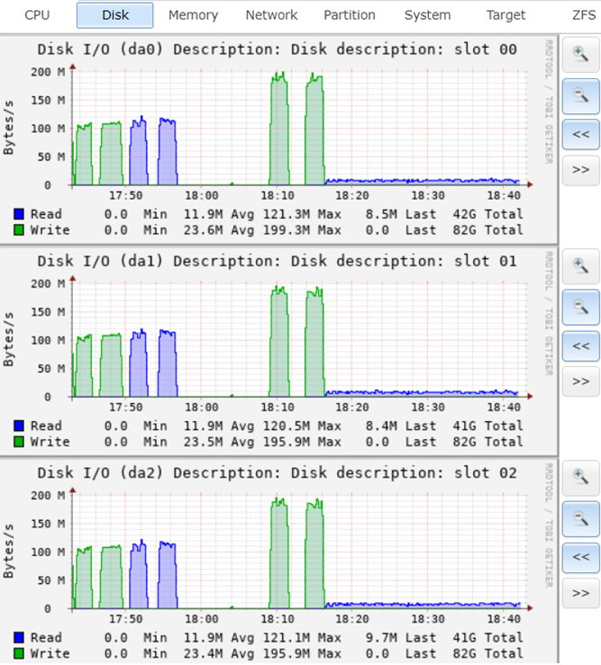

I've attached a screen grab taken from within FreeNAS during DD testing. The first 4 blips on the graph is me running 2 read tests then 2 write tests. The array was 2 x 8 RaidZ2 configuration, the test used bs=2048k and count = 100k...
The next 3 blips are after I've changed to 8 x 2 disk mirrors... The third blip is the small blue smudge that runs from just before 18:20 to 18:40....The write speed is exceptional, but the read just falls flat on it's face.
Am I doing something stupid with me DD commands?

Unless you've disabled compression on the dataset you're writing to, the dd tests are meaningless. The disks themselves seem to be working just fine, according to jgreco's script.

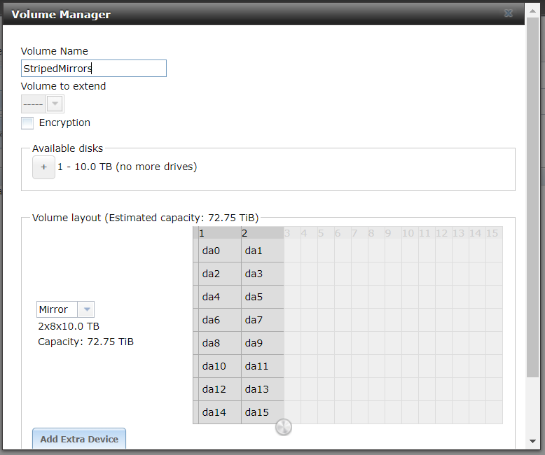

For this build, I wanted to go the whole-hog and run a stripe of mirrors but fell at the first hurdle. I've double checked I'm creating the vdevs/pool correctly and even resorted to manually creating it just-in-case something else was amiss. I spent a day manually creating the array to make sure the paired mirrors where running on separate channels on the HBA just to try and rule that out, which took a few different configurations. But nothing I have done actually makes the stripped mirrors work.
I've attached a screen image in a previous post with the vdevs/pool all setup, but to confirm what I'm doing, I've took another image just before clicking 'add volume'.
