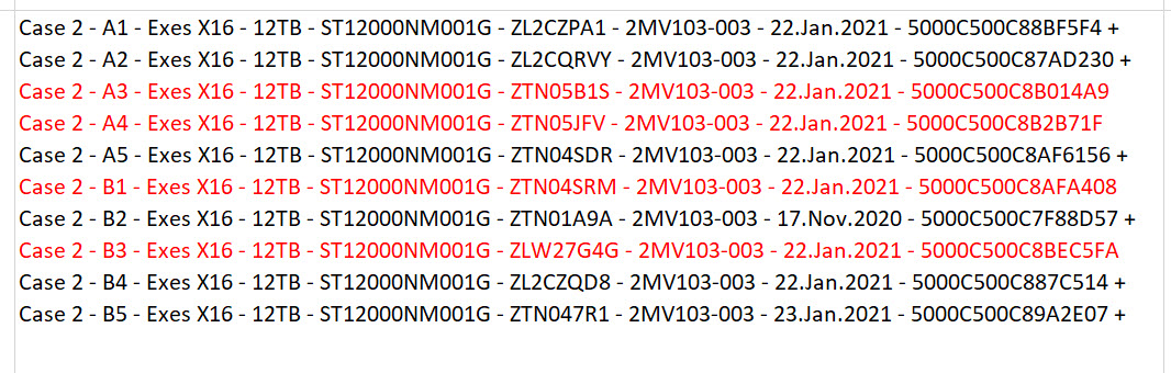

Partly a symptom of how many drives I have running, but I have had to change out 13 failed WD drives in the past two months. Seven in December and six already in January.
