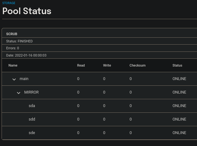

My pool looks fine, like this what is going on here?

Those are 2 different things... your boot pool is not listed under Storage | Pools
Rather under System | Boot | Actions | Boot Pool Status

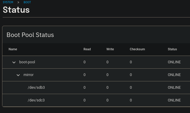

Oh, good to know where I can find it. This is showing up:
Seems fine too right?
9,703
Yes, looks OK... the error was perhaps just a temporary situation preventing the middleware script from getting the expected result when checking on the boot pool. if the error doesn't re-occur, I wouldn't be worrying about it.
