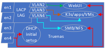

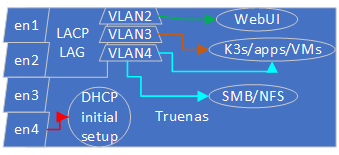

My envisioned setup would be as follows:
en1/2 are 10 Gb/s, en3/4 are 1 Gb/s
en4 would be disabled at the switch level unless there are issues with the other interfaces. Since there are many avenues for issues I decided to simplify.
VLAN1: 192.168.1.42/24
VLAN2: 192.168.2.42/24
VLAN3: 192.168.3.42/24
VLAN4: 192.168.4.42/24
VLAN5, client network accessible through the gateway of each VLAN: 192.168.5.42/24

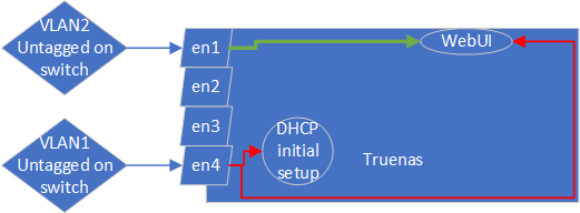

I've simplified for testing:
The WebUI is reachable on BOTH IPs from VLAN5 as long as both Interfaces en1, en4 are connected and active.
- 192.168.2.42 is not reachable if en1 is disconnected.
- The WebUI is not reachable from VLAN5 if en4 is disconnected
- The WebUI is reachable on 192.168.2.42 from a laptop connected to en1 with ip 192.168.2.41 and en4 is disconnected
- The WebUI is reachable on 192.168.2.42 from VLAN2 when en4 is disconnected

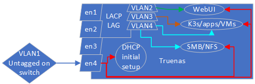

This leads me to believe that established traffic is routed back over the default gateway of vlan1 on en4. The weird thing is that en4 seems to keep it's ip configuration eventhough the nic en4 is down, I can see this when I login using the idrac virtual console.
I've tried setting the default gateway to 192.168.2.1 (default gateway for VLAN2), however that does make 192.168.2.42 available outside of VLAN2. It seems to ignore the defaut gateway.

As for network for my TrueNAS. I've been contemplating this as well and will be testing the following setup, please let me know if you spot errors:
Sorry, for the random iconography. The idea is basically that I have a single ip the management interface is available on. The only thing in this VLAN and subnet is TrueNAS and the firewall. The firewall will then make it available to the rest of the network in the management subnet/VLAN.
It's not the prettiest, but this achieved basically the same thing especially if I make the subnet of vlan666 as small as possible. This will also allow me to connect a laptop to en4 and always be able to access TrueNAS. Well unless I screw up, which is always a possibility!
I'll work this out further and test it when I can get to it, for now work is keeping me distracted ;) I'll post as soon as I have more questions and or results.

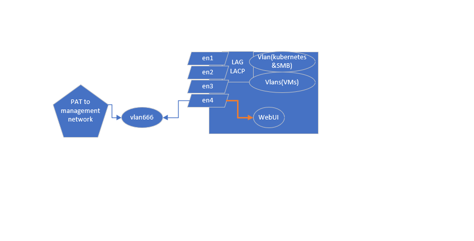

Hi, just wanted to add that I have it running now in a configuration that I find workable and wanted to add the things I specifically found for SCALE.
- A dedicated management LAN is possible, although a bit janky:
-> 1. Use a VLAN or physical LAN adapter in TrueNAS
2. Make the network independent from ANY other network using a unused subnet and vlan/phisical wiring. I would suggest a /31, that gives you 2 addresses
3. Use another device to create a NAT or a PAT (I would recommend the latter so only the port you want is available) from your management network to the address of TrueNAS in the /31 network
4. Configure the web interface to be available only on the IP in the /31 subnet for management
+ This has the added benefit that you can connect any device instead of the device that NATs so you have direct access in the same subnet
+ The interface that exposes your SMB and such will then not expose the webui
- If you get Kubernetes networking errors, usualy it'll mention a CIDR mismatch. Go into the settings of Apps and fix the config. For the dockers to become available if the subnet changed you'll need to reboot. Some dockers took a few reboots for some reason. I often find the advice delete everything and recreate everything, ixsystems dataset and all seeems to be unnecesary in most cases actualy.
- Kubernetes cannot be completely separated from TrueNAS itself (with the standard feature set). The Interface you use has to have an IP configured on TrueNAS and TrueNAS requires a CIDR for it to be configured.
- This brings me to my next point. Which still requires more testing. Selecting the Interface and ip 4 gateway in Kubernetes CAN EFFECT the behavior of TrueNAS.
