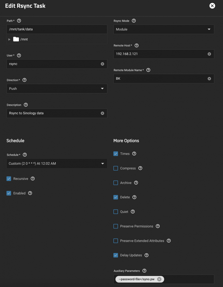

I've updated a couple of days ago to the last bluefin, prior to that the Backup Rsync was working correctly and no other changes have being done.
the task is configured like that:
fails immediately after launch
any idea/workaround?

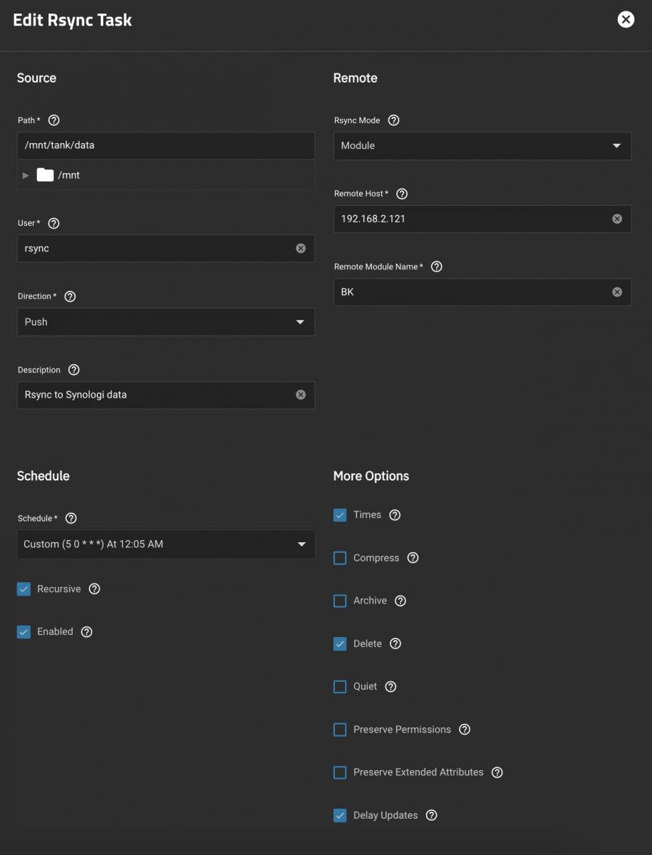

Yes already tried, tried also to recreate the BK rsync module with no luck, fails immediately.
there's a way to have at least a complete log to understand what's wrong? the alert just tell that's failling
