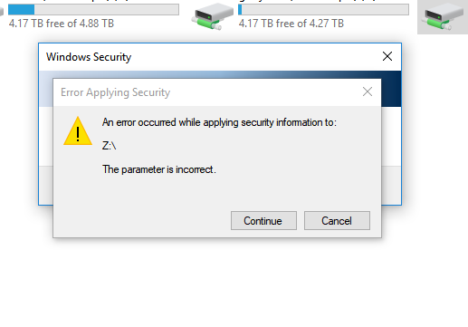

Also, I am now unable to save any permissions changes to any of my shares from a Windows 10 client. Although it does seem that I am able to access all of my previous shares from windows.
This is the error I receive on every attempt to change permissions from windows on any of the shares:

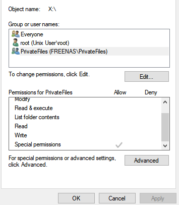

I also noticed that all my shares seem to have this setting now as well on all the previous accounts: They all say special permissions.
Any thoughts on how to correct this, would like to be able to get this back to normal.

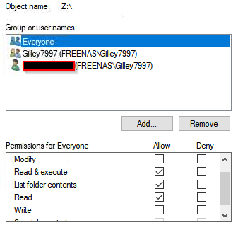

With this configuration in both Windows and FreeNAS the rsync task functions:
The group in windows has the group and owner with Full Access, and the Everyone Group configured as such:
With this configuration the rsync task will complete with no problem, also adding the specific rsync user instead of the Everyone group, will also allow the rsync task to complete with no problem.

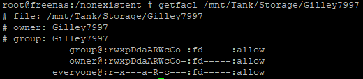

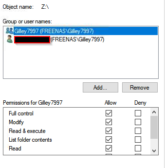

But....If we remove the Everyone group leaving this:
And from the FreeNAS Side:
Also verifying that the rsync user is definitively part of the group Gilley7997:
Running the rsync task results in this:
Does anyone see a flaw in this permission set-up as to why this would be occuring?
