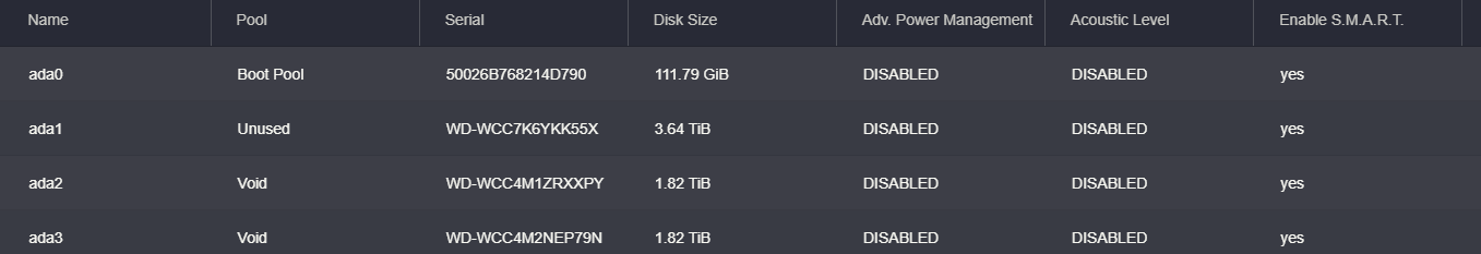

The issue came when I went to remove the old disk, and then put the disk from the enclosure inside the NAS. After turning on the system again, my disk was unavailable and the pool degraded... This is how the Pool Status looked:
And then looking into disks:
So after trying a couple of commands, checking the zpool status through ssh, I got to this error:
One or more devices could not be used because the label is missing or invalid
Looking more into this, it seems that guid wasn't assigned to the new drive, hence it can't be just moved across? This is where I am unsure of what is going on and how to fix this. I tried exporting and importing the pool, as some suggested, to no avail. I think I can manually label the drive through bash, but that did sound like the right thing to do. I would really appreciate help with this

You used USB to resilver the drive.. hence ZFS knows nothing of the drive when you put it back in. USB dosent expose the SATA bus to the system but emulates a drive of the same size. This is one of many reasons people keep saying not to use USB with ZFS.
You need to put the pool back in working order if possible and use a proper connection to redo the resilver.

Well, I don't have any other SATA ports, so this was the only way to do it. Is it not possible to just fix the labelling? The data integrity is there, the poll works correctly while connected through the USB. Surely, there is a way to just move the drive into the NAS without having to do resilvering again?!
I've tried btw to add the old disk back, but perhaps because the data changed since then, its now also unavailable. So if I to do a resilver, it'll have to be with just 2 drives in place. Can I just wipe this new, 3rd disk, connect it into the NAS and then get the data just from the 2 disks?

No, it isn't--you could always offline one of your existing disks. That isn't ideal, as you lose redundancy that way, but it's certainly a possibility.
Yes, of course, as long as there aren't any data errors on those two disks--that's the point of RAIDZ.
Sometimes USB enclosures/docks do stuff (technical term) with the data, such that what's seen when the disk is plugged into the dock isn't the same as what's seen when it's plugged into SATA. Sometimes they don't. My general (albeit limited) experience has been "they don't", but that clearly isn't what's happening with you.
