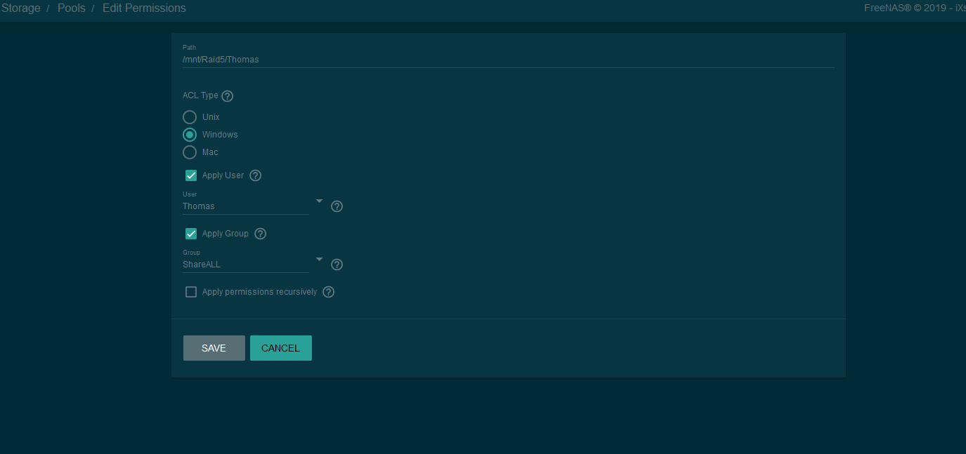

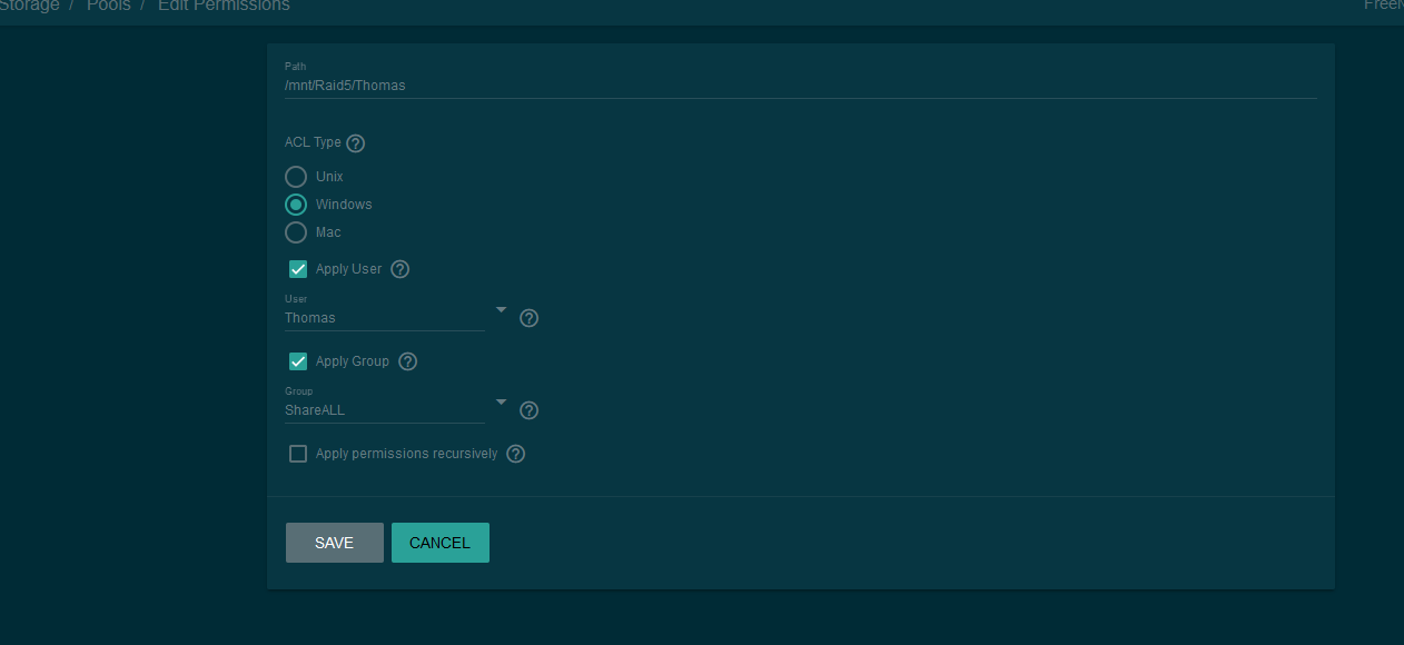

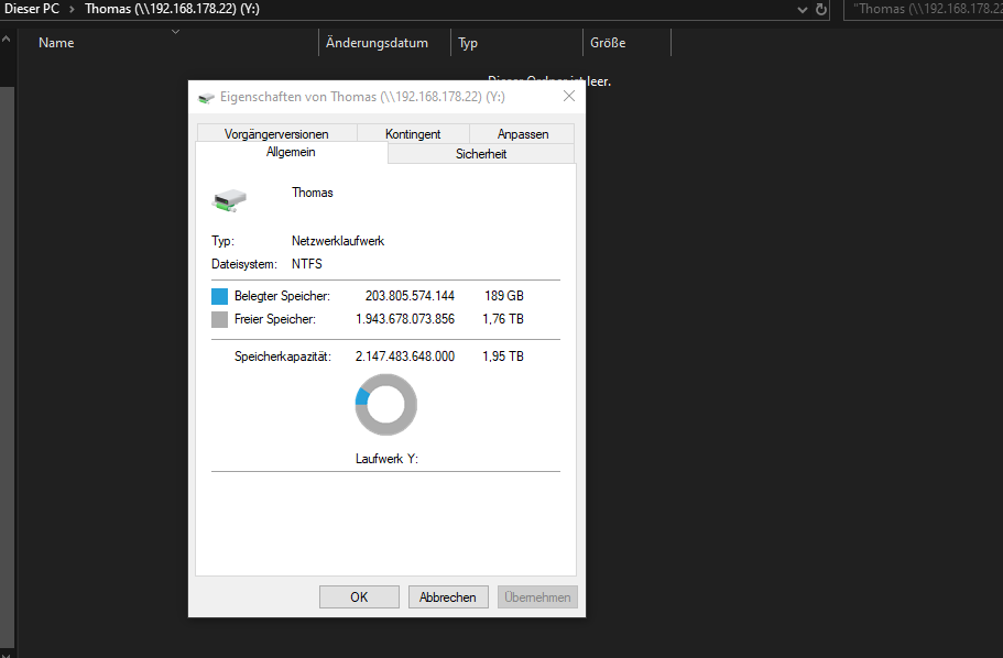

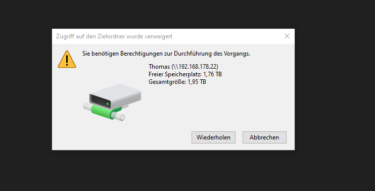

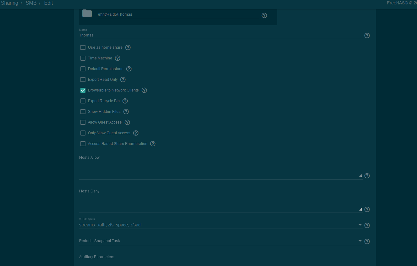

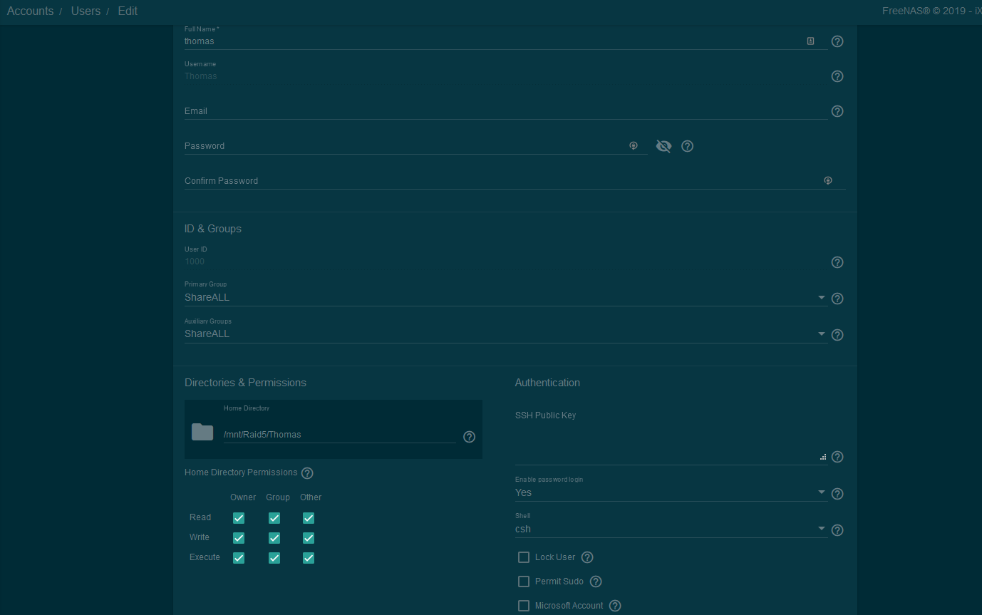

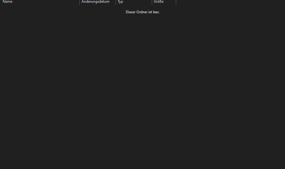

Good evening, I hope you can help me.
Yesterday I screwed up everything again what I can screw up. I tried Webdav wich also worked, only when switching back to SMB Back worked nothing at all.
I am indeed shown that I have full access but I can not see my whole files, but if i watching in the selection for the home directory i cann se there is something.
It is also indicated that 180 Gb is used by 1.78Tb. I can not see or create folders.
Photos are attached if something is missing please tell me I submit it.
Hope you can help me I'm at a loss.
My Englisch is not the Best Sorry :/
MFG Taylor

Hey Taylor,
This is almost certainly related to filesystem permission being wrong.
The Webdav sharing service is limited in FreeNAS and only the default webdav user will work. For that service to work, permissions must be configured for that specific user. Should you try to re-share the same resources using SMB, you will have to mount the share using the same WebDav user for you to end up with the same access.
If you access SMB using a different user, then you will end up with problems. Remember also that Windows ACL and Unix ACL are not the same.
Good luck fixing your setup,

I have withdrawn everything, i switch back tp smb and Microsoft i got Acess on a other Folder.
I also finished Webdav to use Webdav than i changed the user from Webdav to my user Thomas and i can`t see the folder.

i USed at first SMB than i go to webdav thats the Problem and now i wnat back to Smb but i cnat see my data.
is there a solution to restore it?

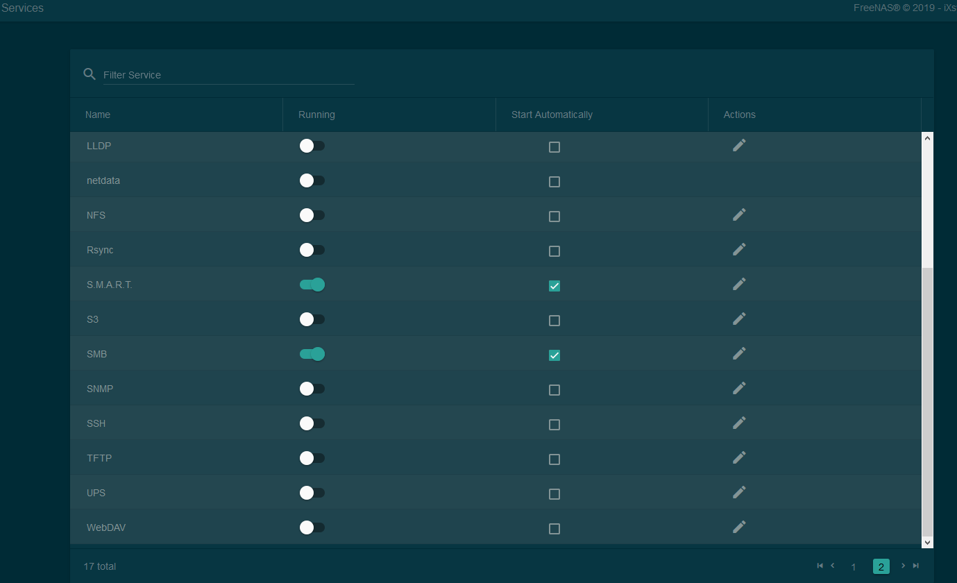

i Activate SMb and deactivate webdav

I have several folders for each 3 people everyone should have access to his folder
Heracles
Feb 2, 2018
1,401
Hi again Taylor,
So if everyone is meant to have the same access to the data, ACL will be easy to reset. Because everyone is meant to have the same access, there is no need to authenticate anyone. So enable Guest Access and limit the access to Guest Only. You do so by checking these two boxes in the shared folder definition.
Know that some resources are case sensitive and some others are not. Also, the same thing can be case sensitive for one but not for the other. Usually, usernames and group names are kept lower case. In your screenshots, we see both with some upper case. I recommend you to use only lower case for both. Thomas may not be the same as thomas, just like ShareALL may well end up different than shareall.
So create yourself a new lowercase username for your data like : smb-anon
Also create yourself a new lowercase group name for your data. Re-use the same name and both will be dedicated for that use : smb-anon
Because you are not using different accounts for different access from Windows, you do not need Windows ACL. So switch back to Unix ACLs in Storage / Pool / Permission. There, fix the permission for your dataset "Thomas"
In that screen, reset ownership and group to your new user and new group "smb-anon". Also, put 755 as permission and check for it to be done recursively.
Once your permissions are restored, you should be able to access your share without username and password and everyone should be able to access the data, read it, delete it, etc.
Beware that this is true for anyone on your network. If that is not what you are looking for, you will need to design your access control before enforcing it.
Good luck fixing everything.
