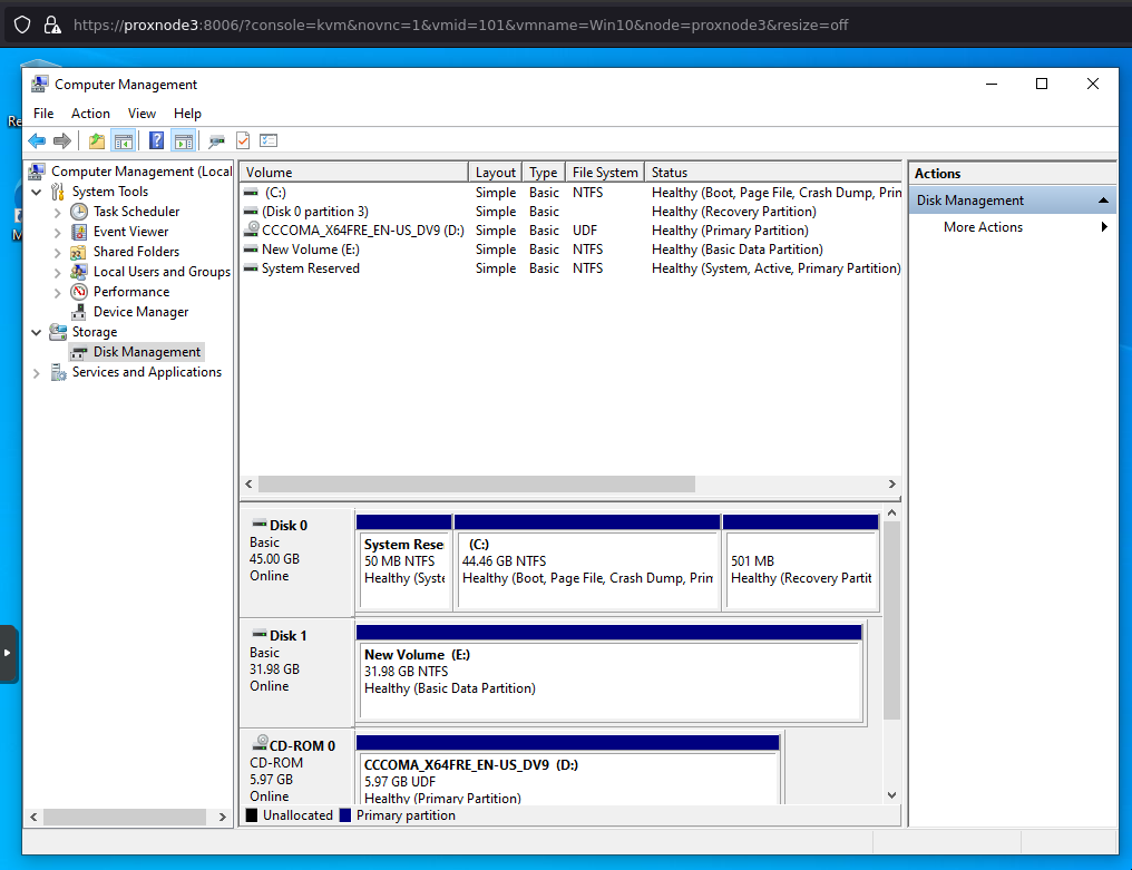

Out of curiosity, I just tried this. The only difference on my side is that I share out disk space from my TrueNAS server to my Proxmox cluster via NFS and not SMB.
So anyway, I created a second IDE disk in a Windows 10 Virtual Machine and allocated 32GB of shared storage to it. Fired up Windows, added a GPT partition table and formatted the disk to NTFS as a new simple volume. (Disk 1 in the picture)
No problem at all. Maybe it's the fact that you are using SMB to attach the shared storage to Proxmox that is key here.
