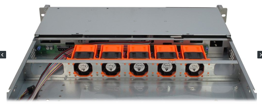

Also, in a 1U chassis, having the memory going crosswise to the airflow direction will significantly impact CPU cooling.
Those fans right there:
They are the double thickness, high RPM server fans and if you change them out for the wimpy little fans from Noctua, you will not get enough airflow to keep your drives cool much less enough to keep your system components, like the CPU cool. You can't just go changing fans out in a chassis without giving consideration to the cooling. These people have engineers that worked out the math. They didn't put that kind of fan in there just for fun.

EDIT well yes that motherboard wasn't design to properly fit in a 1u server due to the ram placement and this will lead to major heat issue so i will probably take a 2u server http://www.fantec.de/produkte/serve...dukt/details/artikel/1670_fantec_src_2080x07/ (all their website is wrote in german)

And i have already modified the 1u server case (the ram placement on the motherboard would lead to a inefective cooling) to a 2u case with the recomendation of chris moore.
