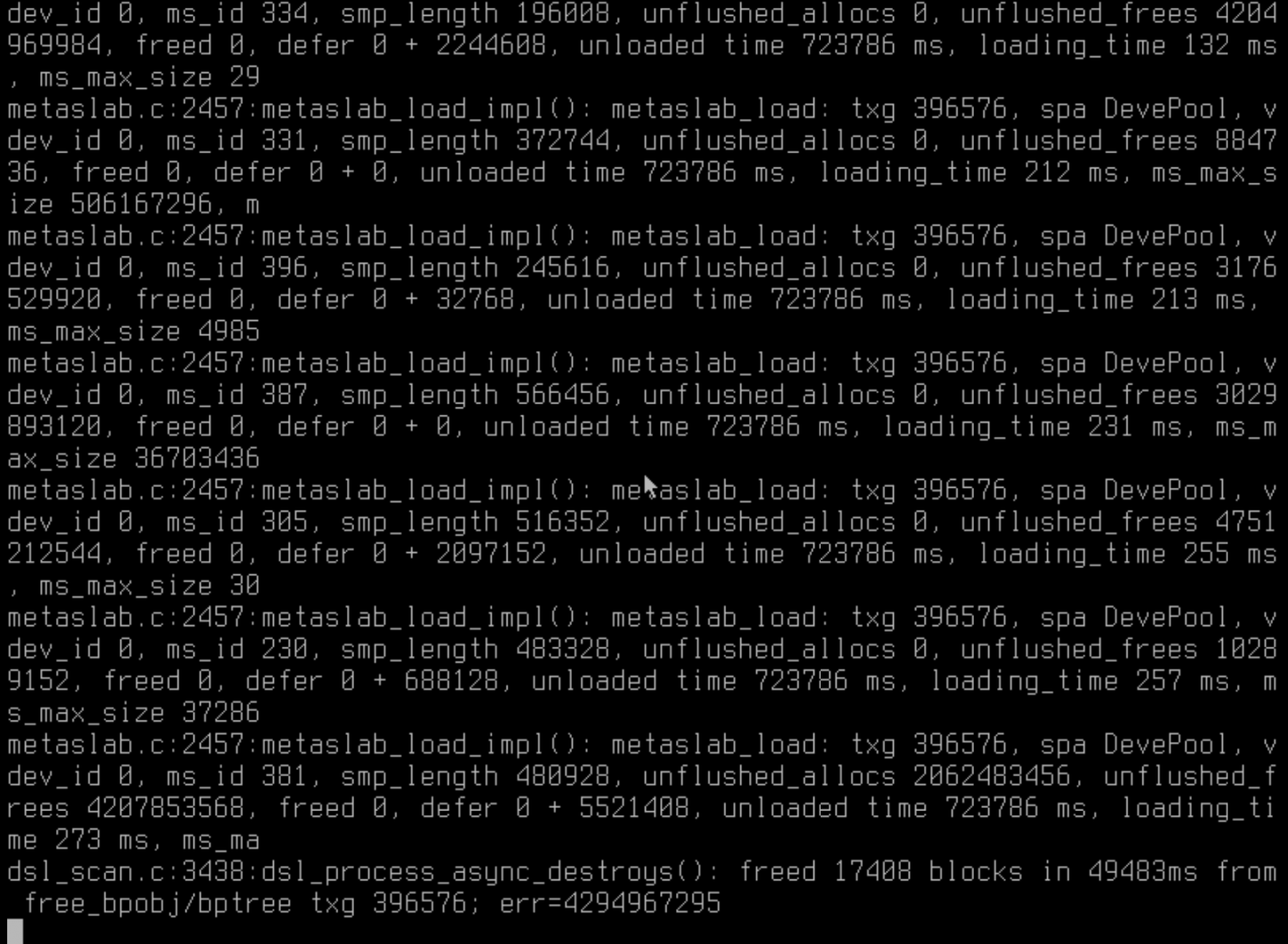

Today I turned the server on again and tried removing some snapshots because the disks were almost full (95%) which seemed to work fine. I also went to the Shell and deleted a directory that was taking up a lot of space.
When I came back a few hours later the Web frontend was unavailable and the server itself was showing some strange information. I managed to trigger a shutdown which got stuck after unmounting 4 things (I don't remember the exact name) so after about 4 hours I did a cold reset.
The server is doing things
Now the server is doing all kinds of things but I have no idea if it's good or bad. Again, the data on the server isn't crucial but I'm curious what went wrong, how to fix it and what else I can do.

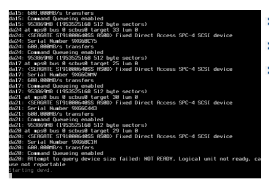

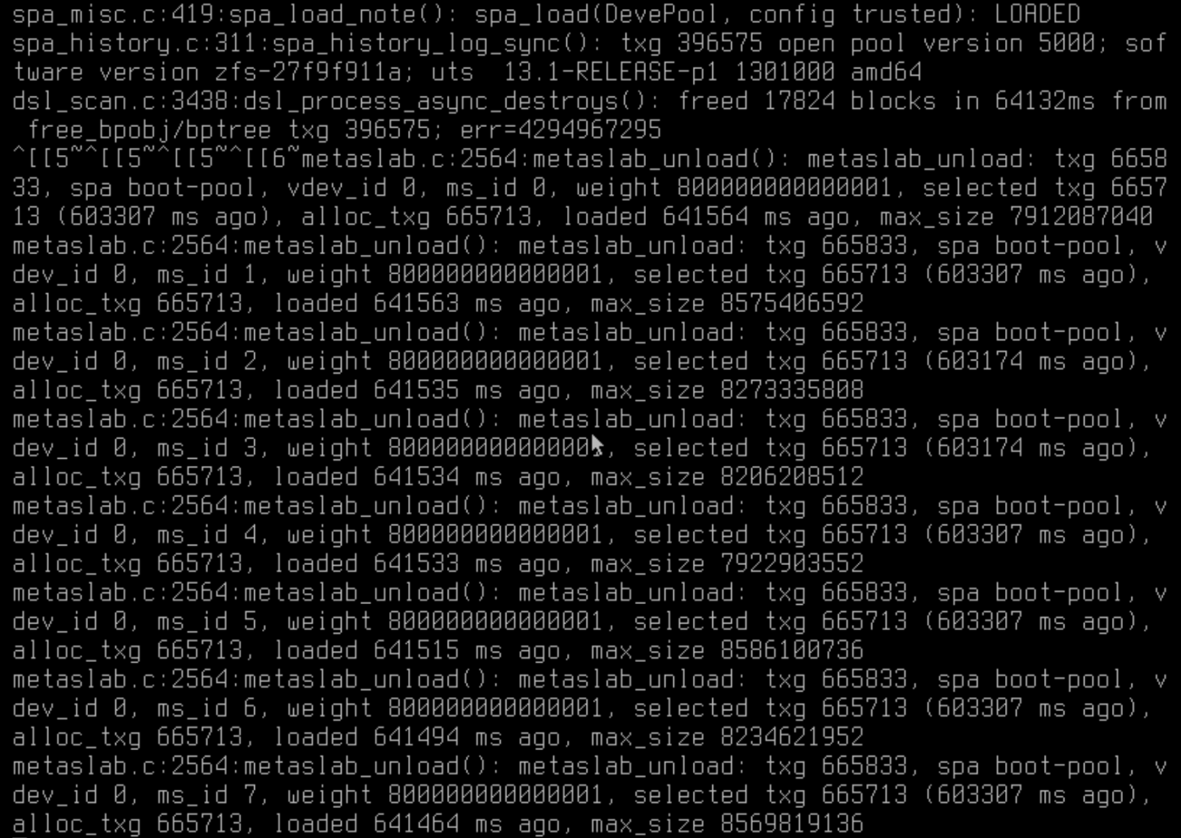

I attached screenshots 1 and 2 to show what the server displays now. I believe screenshot 3 is something from a few minutes earlier (harder to read since it's an iDRAC screenshot)
Does anyone have an idea what's going on here?

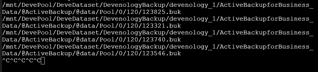

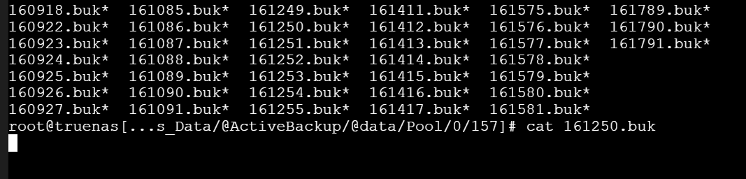

A problem I'm running into now is that the system seems to be "hanging" again. I tried removing a whole directory tree by calling `rm -v -R /mnt/..../blah` which worked fine for a few minutes but seems to be hanging now (screenshot 1).
I tried to open a new shell and simply `cat` a file, but this also isn't working anymore (screenshot 2).

Basically, you've run out of memory. Instead of being able to do lookups in RAM at the speed of "gigabytes per second" you've been reduced to lookups on disk at a probable speed of "kilobytes per second"
Your disks are being overwhelmed by very small I/O as they update the deduplication metadata ("block X, Y, and Z used to be a copy of block Q - block Z got deleted, so we need to update") - spinning disks are not the best at handling it in an optimal scenario, but the single 24-disk wide RAIDZ3 layout is going to exacerbate that as there's twenty-four disks that need to rotate to the right spot.
In screenshots 1+2 you can see that the txg (transaction group) number is incrementing very slowly for your main pool "DevePool" - it starts on txg 396575 where it reports 17824 blocks freed in 64132ms - the next transaction group is txg 396576, where you see a huge number of metaslab load and unloads as it's trying to pull your deduplication table into memory and make space to work on it. Finally you reach the end of 396576, where 17408 blocks are freed in 49483ms.
As a yardstick, a transaction group is normally allowed to exist for a maximum of 5s with the default tuning. So if your system needs to spend an extra minute doing "housekeeping" for every 5 seconds of writes put in it ... it's going to have a poor time keeping up and appearing responsive.
If you can safely shut the system down and add more RAM (I would try to double it, at a minimum) this may help make the system somewhat more responsive, as it will no longer need to evict metadata that it will then have to re-read again - but ultimately, the way out of this will likely involve removing deduplication, and probably a pool re-design to use multiple smaller RAIDZ2 vdevs to regain a little performance and split up the large 24-wide Z3.

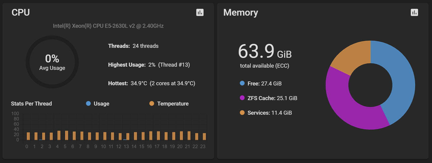

My memory usage seems to be quite okay now:
Or is this not an accurate graph?

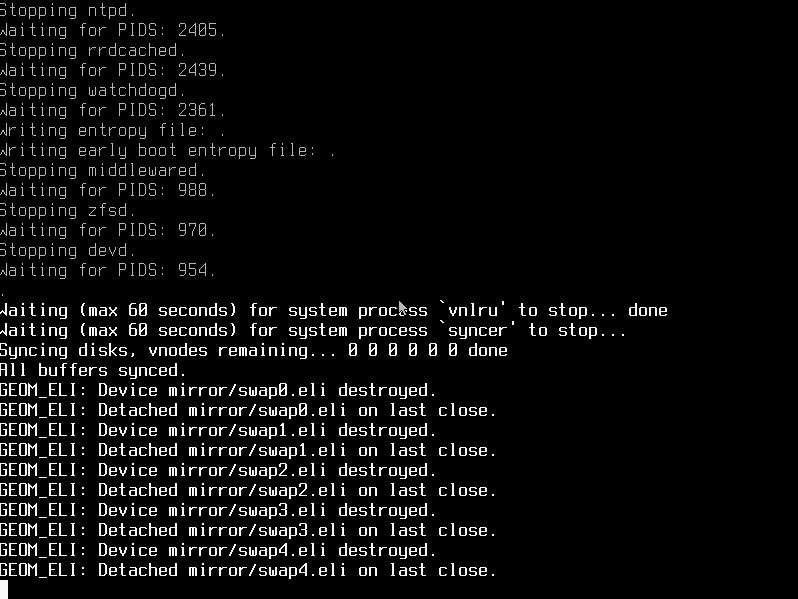

Another error I'm running into is when I try to shut down the system now it hangs on the following:
What could that be?

Well compression is already activated and set to one of the higher levels. Again for my usecase my backup fits with dedup enabled and doesn't with it disabled :).
jgreco
Resident Grinch
May 29, 2011
18,680
What could that be?
I expect that if you wait long enough, it'll finish whatever it's doing. You could also try ^T.
Basically, the dedup, the super-wide RAIDZ3, and the degraded RAIDZ3 are conspiring to kill you.
jgreco
Resident Grinch
May 29, 2011
18,680
Since you're well past the 80% mark, this statement would appear to be categorically false.
