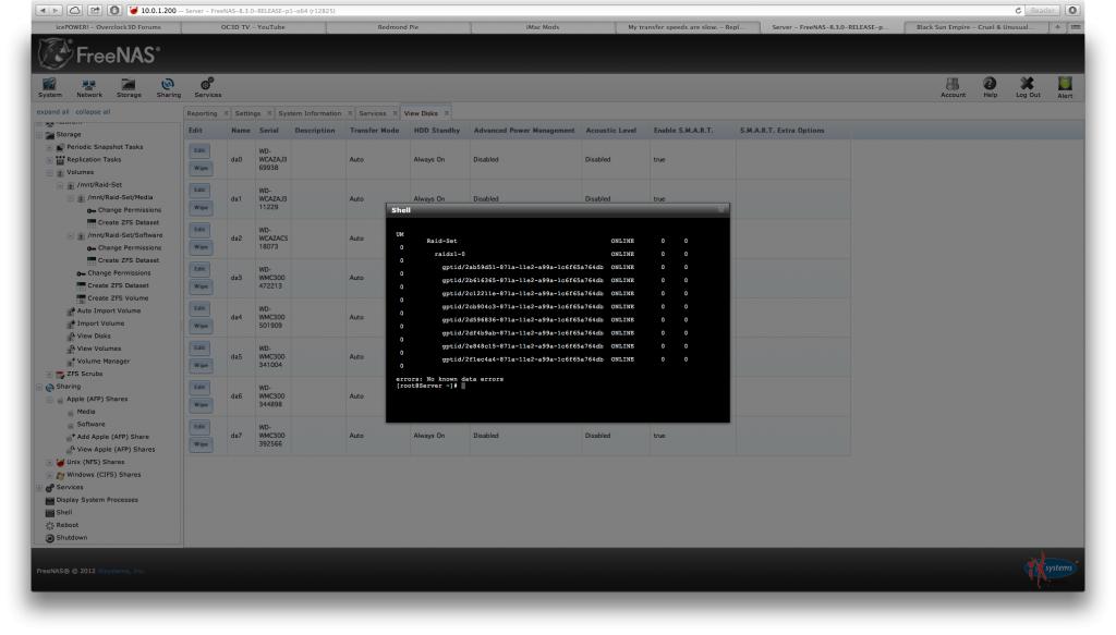

What version of FreeNAS are you running? Your system is plenty powerful. Do you have compression compression? What about dedupe? Show us the output of "zpool status" from a FreeNAS console window (you can use SSH if you have that enabled).
I am using "FreeNAS-8.3.0-RELEASE-p1-x64 (r12825)"
I dont think i have compression enabled... or dedupe ? Is there any way i can upload all of my settings for someone to check?
Here, Is this what you mean??...

Can you post the output of zpool status from an SSH session as root and post it inside of [code][/code]

Like you said it doesnt appears to be a drive failure as this here says "No known data errors"...
Chriss-Mac-Pro:~ Chris$ ssh -t  root@10.0.1.200 -p 22 "cd /root && exec \$SHELL"
The authenticity of host '10.0.1.200 (10.0.1.200)' can't be established.
RSA key fingerprint is 75:2c:aa:e8:9a:c2:35:04:b8:ed:0f:d9:3c:63:bb:93.
Are you sure you want to continue connecting (yes/no)? yes
Warning: Permanently added '10.0.1.200' (RSA) to the list of known hosts.
root@10.0.1.200's password:
[root@Server] ~# zpool status
  pool: Raid-Set
 state: ONLINE
  scan: none requested
config:
	Raid-Set                                        ONLINE       0     0     0
	  raidz1-0                                      ONLINE       0     0     0
	    gptid/2ab59d51-871a-11e2-a99a-1c6f65a764db  ONLINE       0     0     0
	    gptid/2b616365-871a-11e2-a99a-1c6f65a764db  ONLINE       0     0     0
	    gptid/2c12211e-871a-11e2-a99a-1c6f65a764db  ONLINE       0     0     0
	    gptid/2cb904c3-871a-11e2-a99a-1c6f65a764db  ONLINE       0     0     0
	    gptid/2d596836-871a-11e2-a99a-1c6f65a764db  ONLINE       0     0     0
	    gptid/2df4b9ab-871a-11e2-a99a-1c6f65a764db  ONLINE       0     0     0
	    gptid/2e848c15-871a-11e2-a99a-1c6f65a764db  ONLINE       0     0     0
	    gptid/2f1ec4a4-871a-11e2-a99a-1c6f65a764db  ONLINE       0     0     0
errors: No known data errors
[root@Server] ~#
- Did i do that right?

The zeros are a good indicator that the drives aren't bad, but they aren't a "sure thing". Those values also change on every reboot and if you do a zpool clear.
I'd get SMART info for all of the drives to see if anything looks bad and I'd start a scrub unless you plan to do anything that will need the computer for the next 2-24 hours. The scrub is dependent on the speed of your drives, the amount of data in your zpool, and your CPU's ability to do the scrub calculations. I'd expect that your zpool if it were 100% full would take between 3 and 6 hours. Of course, other factors can cause this value to change.

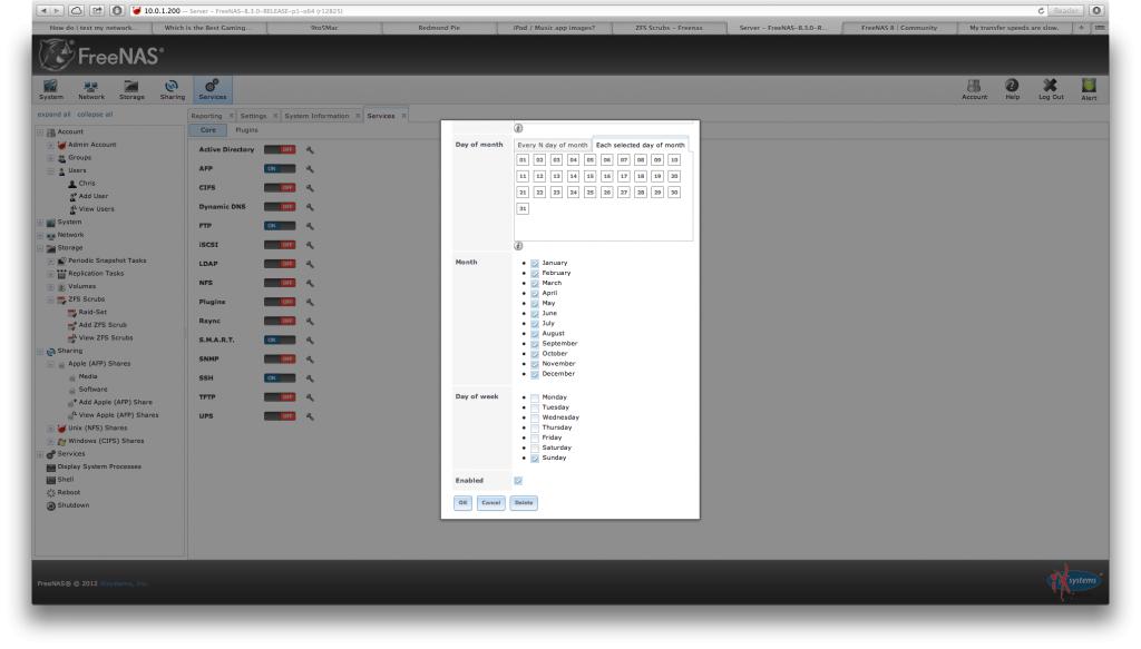

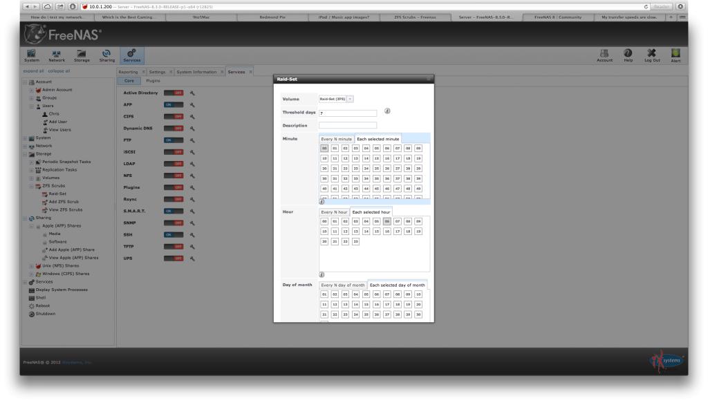

Hello. I have tried setting up a scrub using the Freenas manual but i want to make sure i understand it right.
If i understand right, i have it set to scrub every Sunday at 06:00? I based the 7 day gap on the recommendation for consumer drives and chose a time where an impact on performance won't matter.
Can anyone please confirm this?
