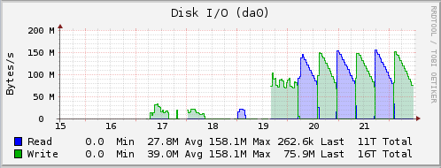

Hello Everyone,
Being a noob and this is my first post, I'm not not sure if this is the correct topic forum to post this in. Please feel free to move it.
This is probably common knowledge here and I have known about it but tend to forget it until I saw it visually. I see people get hung up on performance numbers especially with hard drives. I just wanted to share with other newbies that hard drive transfer speeds do vary depending on where on the hard drive the read/write is taking place (outer track vs inner track). When comparing drive specs from manufacturers they may only list one number and that number is probably the highest transfer speed of the drive. But the drive can go slower. How much? I don't know. I just finished building two FreeNAS boxes and I am in the hard drive burn-in portion (patiently waiting...). Every now an then I would look at the SSH sessions and reporting graphs of the disk I/O just to check to see how things are going. It was then I saw how much of a difference in transfer speeds from the high to the low.
This chart shows one of my WD Red 4TB drives during the badblocks burn-in phase and you can see the transfer rate goes from a high of 158 MB/s to a low of 76 MB/s.
Side note: For those of you considering building your own FreeNAS don't forget to allow time for hard drive burn in. Each one of those alternating color "steps" represents nine hours of reading or writing to the disk.
9 hours? Lucky you, my 3TB Reds took some 7-8 hours for each badblocks step. Plus the read time. Times 4 passes. Times three runs (didn't have the rest of the server yet, so I had to do the burn-in on the old one).
