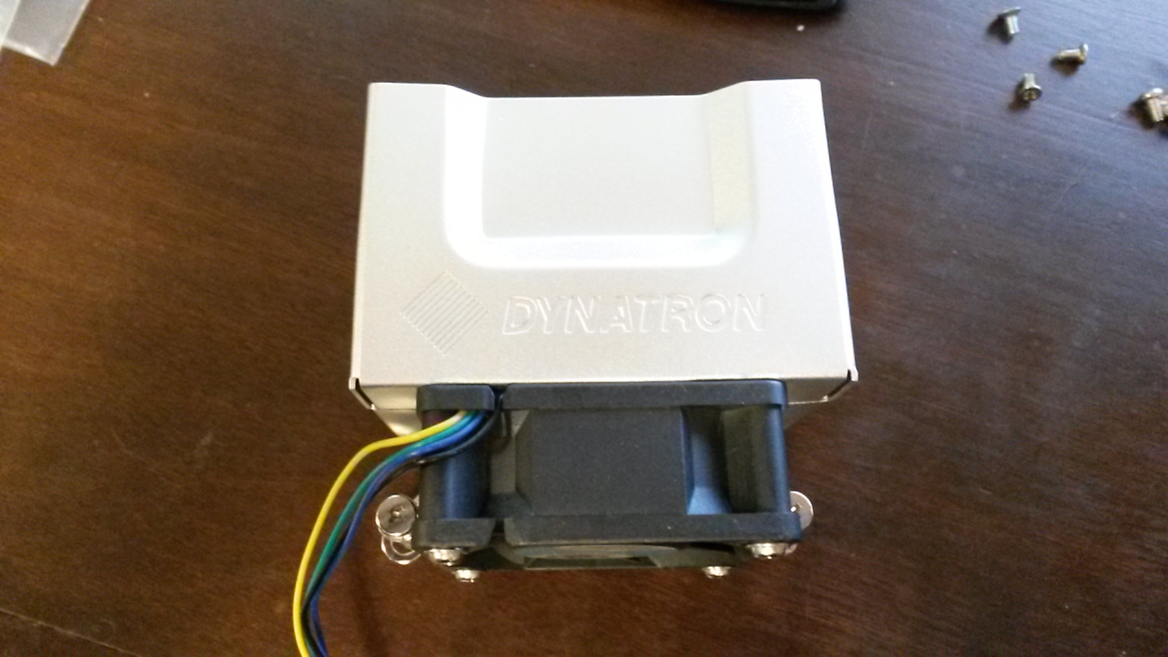

Sitting mostly idle, right now, the average core temp is 40c. The screen capture I posted a few days ago was under load and it maxed out at 73c. It is within the thermal limit for the CPU, but I don't like it. I don't know if you looked at all the posts, but I just changed the CPU cooler to try to get less sound under load. The old one kept it cool but at the cost of undesired sound, this one is quiet but at the cost of undesired heat.However, I can't believe that your CPU is actually getting that hot if it's not under load.

Yeah, I saw that. That's why I was asking about the mounting angle. Some heatsinks are sensitive to orientation (their heat pipes align a certain way, and pretty much all CPUs have rectangular dies), and that was the first thought that popped into my head. I don't know anything about that particular heatsink, but it looks like it should do a better job than what it's doing.I don't know if you looked at all the posts, but I just changed the CPU cooler to try to get less sound under load.

This is the second CPU cooler like this that I have used and the other one worked fine. I do have it oriented so the exhaust air blows toward the rear of the case, which is how it is intended to be used. It is really made for a 2U chassis and I am guessing it was designed to be just enough cooling to prevent the CPU from thermal throttling.I don't know anything about that particular heatsink, but it looks like it should do a better job than what it's doing.
