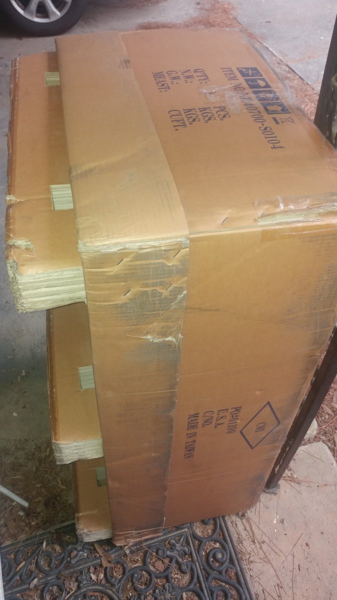

It's pretty cool. They come on their own little mini-crate. 20180214_163919.jpg
I was a little surprised which how flexible the drive caddies are. I'm sure it's not a problem, but compared to the OS drive caddies the main ones are much less rigid.
I haven't read the manual yet, does it give you any advice on the order to install drives? I'm guessing it's best to fill an entire row at a time? I don't even have a system to install in it yet as my current box is a proprietary server and it wont fit in this case.
Apr 9, 2015
1,258
Yeah the crate is all cardboard, it's interesting but got tossed the same day, LOL.
The caddies are just plastic aligners from what I can tell. They do kinda click in place with a little friction but no latches, once the lid is on though they won't go anywhere and gravity will hold them down as well..
Not sure on the drives but I would try and spread the load between each backplane. When I get started transplanting I am going to label the drives with Pool, vDev, and Serial so I can keep track of everything.

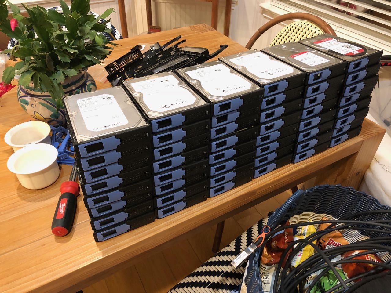

The hardest part of connecting the SAS cables was the fact that all the hard drive trays need to come out first. Then the trays that hold the backplanes can be unscrewed (thumbscrews on the front of the chassis) and slide forward a few inches (without disconnecting any of the already connected cables) to allow fingers to get into where the connectors are.
I'm new to backplanes and wonder if there's an advantage to running each backplane on separate cards? I have a Supermicro X9DRD-7LNF4 with dual onboard LSI 2308 SAS controllers. I also have a couple of LSI 9207-8i cards, so my questions are:
1. Is there an advantage on moving the backplane connection to one of the cards?
2. Is there an advantage on running each backplane on a different card?
My guess is I can run it all off the motherboard, but if your experience differs, I can try something different.
Thanks for your advice.
