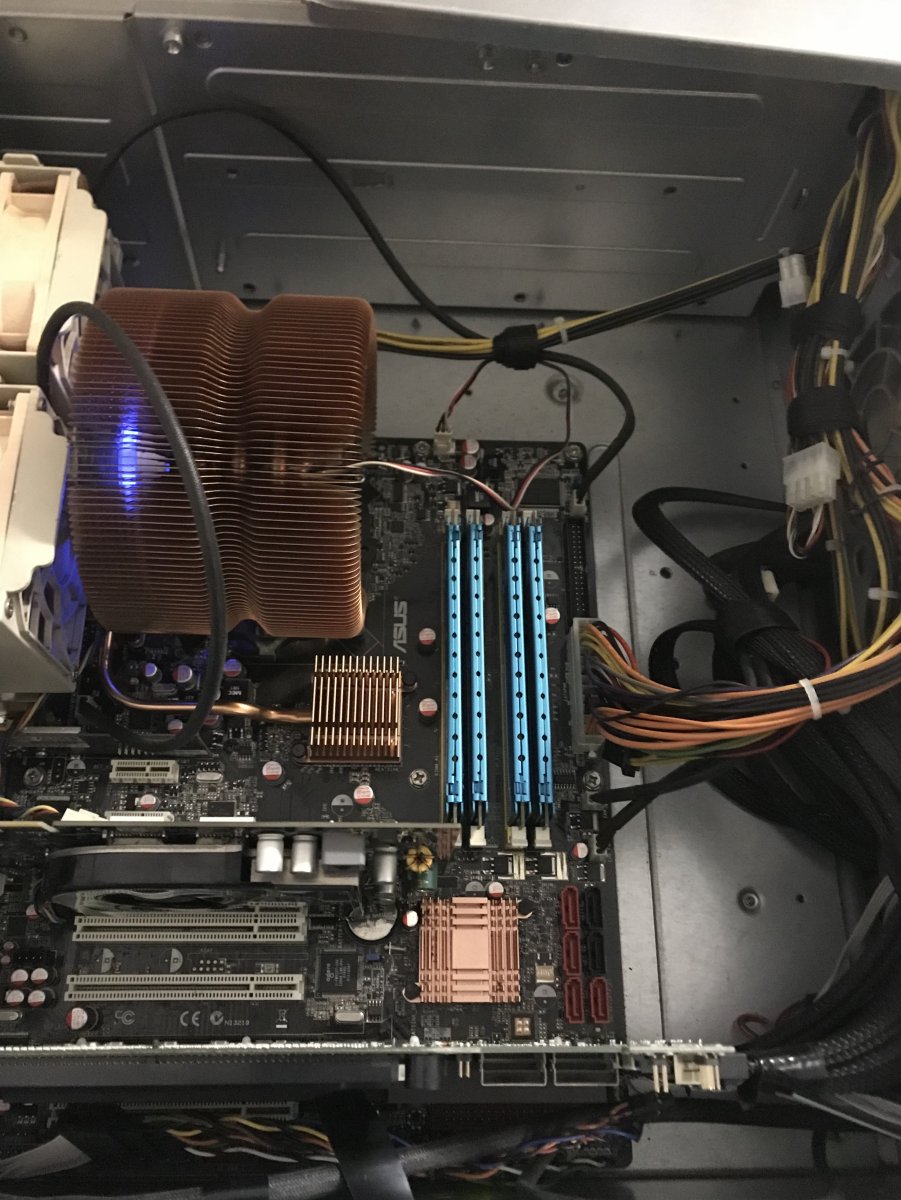

Hi guys,
I’m reusing my old mobo Asus P5K-E for my freenas file storage. It’s been working fine except every time it reboots I have to take 1 Hdd out and wait for booting progress then reinsert that hdd in (because the boot drive can only be recognized in bios when using 11drives). My case supermicro 846 EL has 24 slots but so far I can only use 12 due to this limitation. Is there anyway I can solve this issue? Is there a way to make it boot when using >11hdds? Must I upgrade? I have a supermicro X9DAI-o with dual Xeon 2560 V2 & 64GB to be used for Freenas but only if I must upgrade. Is this configuration any good? My hdd controller is Adaptec 24 ports use as JBOD pass through (I know LSI HBA is better but I try to reuse as much as I can). Please advise. Thank you all.
My current configuration:
- Mobo: Asus P5K-E bios 2.58
- CPU: intel core 2 Quad Q6600 2.4GHz
- RAM: 8153MB (maxed out ☺️ I know it’s freenas minimum...)
- Hdd controller: ARC-1880 24hdd
- Case: supermicro 846EL
- Freenas 11.1 - U5
- PSU: Supermicro 1200W

Chris, I will eventually switch that raid card. I need a 24 ports with less PCI. I eventually upgrade parts so I intend to upgrade to LSI 9305-24i then mobo+cpu+ ram... What should I do to take advantage of 12Gb/s or just can’t at all?
My case can handle 24hdds so is it a waste using sas expander? I updated my original post with configuration. I meant that my Freenas can’t handle >11 hdd.

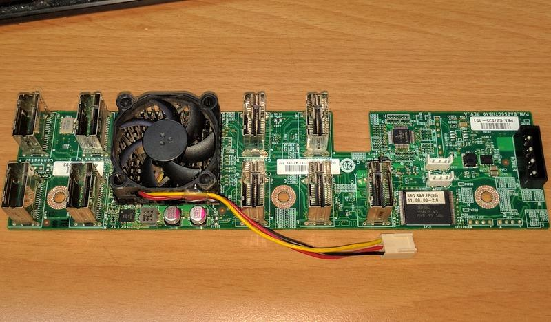

You could use a SAS Expander like this one:
https://www.ebay.com/itm/RES2CV360-INTEL-36-PORT-6G-SAS-EXPANDER-BOARD-FOR-INTEL-R1000-R2000-TYPE-SERVERS/132665195104
It would allow you to use two cables like this to connect back to the SAS Controller:
https://www.ebay.com/itm/2Pcs-Mini-SAS-36Pin-SFF-8087-to-36Pin-SFF-8087-SAS-Data-Internal-Server-Cable-1M/202094506489
You could use the rest of the ports on the expander to connect forward to the direct attach backplane, which does not care what the attached drives are, so it doesn't need to be changed.

I don't quite understand this one. Where should I plug it to since it's not PCI express?
on all the SAS expanders they get the data through the SAS cable not to the PCI Express interface. PCI Express is just there for the power

To me it resolves to RES2CV360 INTEL 36-PORT 6G SAS EXPANDER BOARD FOR INTEL R1000/R2000 TYPE SERVERS which seems to be a bare PCB... It has some mounting holes similar to motherboard mounting holes... Where to attach it? Or just tie the cables nicely and this way make the cables secure the PCB? The PCB seems lightweight so it seems ok in terms of preventing dangling...

Yes, there are options, but take a look at the photo in this post to get one possibility:
https://www.ixsystems.com/community...ro-x10-sri-f-xeon-e5-1650v4.46262/post-409299
There is some discussion around that. Basically, that card just needs power and SAS connections, AND some airflow over that heat-sync to keep it cool.
Some people have even added a fan to make sure:
I have a server chassis at work that uses two of these to run 60 drives, 30 drives on each expander, and each expander has a link back to a SAS controller. I manage several servers that have 60 drives, and this one was originally using HighPoint Rocket 750 cards but I changed it over to SAS controllers instead.
@Stux , did you ever take photos of your SAS expander during / after the installation? I don't recall seeing any more photos of it.
