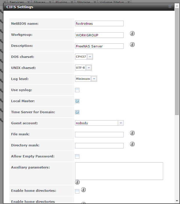

Hi all, I'm trying to configure a windows CIF share and everything seems to work except for this issue. When I try to move a file that has a Zone Identifier from Windows 8 (NTFS volume) to FreeNAS, it gives me a permission denied.
When I right click on the file and select properties and click on Unblock. I am able to move it over to FreeNas without any issues.
I have tried to set FreeNAS as a trusted intranet zone but with no avail. Is there a way I can tell FreeNAS to ignore this Zone Identifier bit? without the hassle of doing this to every single file

I have not tried a W7 client yet. This is a stand alone freenas server, not an AD server
Specs of FreeNAS server:
FreeNAS-9.2.1.8-RELEASE-x64 (e625626)
GIGABYTE GA-H61M-S1 LGA 1155
Celeron G1610
8Gb (2x4gb ECC ram)
3 hard drives in RaidZ1 (320gb each)
2 hard drives in Mirror (150gb each)
See attached for smb4.conf file
  • smb.conf.txt

Well I blew the whole nas away and started over from scratch from a fresh install of FreeNAS. Same issue came up, This time I just created a ZFS volume, then added a CIFS share to toss a file on there. Still no luck.
foxtrotniner
Nov 5, 2014
9
I believe I have solved it. It was a permissions issue with FreeNAS, I'm not sure what happened the first time I installed it but the permissions were set and yet no dice. Not sure exactly which solved it as I did multiple things at the same time but these are the things I did:
1. make sure when you add a user, use your Windows login name and password
2. make sure you set FreeNas to the correct workgroup
3. In the storage tab make sure to click on the permissions button on the bottom, then leave your Owner (user) as root and change your Owner (group) as your Windows Login group name
4. Make sure to reboot your FreeNAS as well as your Windows client to complete.
No more need to edit gpedit in windows anymore! WIN!
