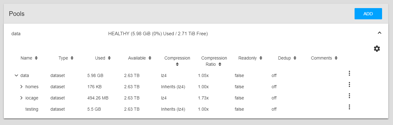

Well it could technically be any dataset on your target FreeNAS server. If it already exist you need to put a -F after the receive part. If the child dataset doesn't exist on the target server it will be automatically created.
So in my example, I have a test FreeNAS server with this setup, this is my target server.
I just used the following command to move a snapshot I created on the source server.
zfs send data/testing@manual-20190210 | pv | ssh freenas-test zfs receive -F data/testing
After this was done I could access the data from my /data/testing dataset on the source server on the new server.
I could have also used this command, and then it would have created a new child dataset on the target server.
zfs send data/testing@manual-20190210 | pv | ssh freenas-test zfs receive data/testing/new_dataset
The pv bit will show the transfer speed you are getting. Moving 20 TB of data will take quite some time.
