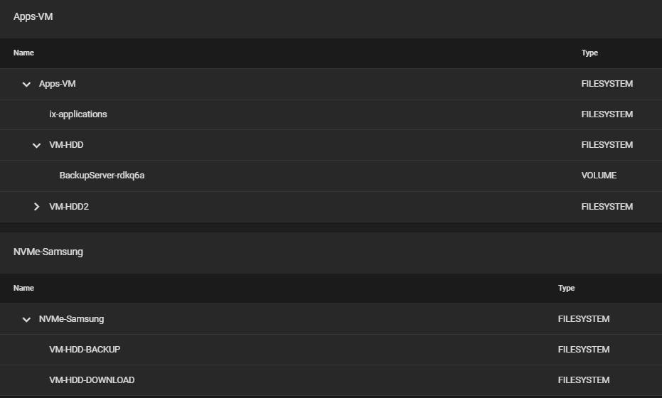

In short I am moving my VM image from my "Apps-VM" pool. The date structure to my VM Image is
Apps-VM/VM-HDD/BackupServer-rdkq6a
I am wanting to move this to me "NVMe-Samsung" pool. The data structure would be
NVMe-Samsung/VM-HDD-Backup/BackupServer-rdkq6a
Here is a screenshot of my structure for better clarity

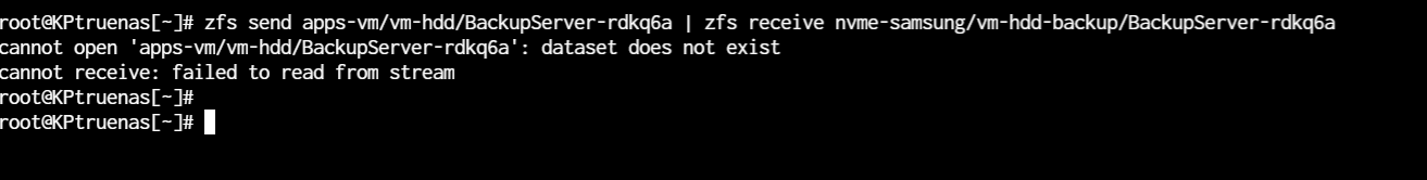

I tried the following command in shell
zfs send apps-vm/vm-hdd/BackupServer-rdkq6a | zfs receive nvme-samsung/vm-hdd-backup/BackupServer-rdkq6a
However I received the following error:
Any assistance would be greatly appreciated.

Patrick M. Hausen
Nov 25, 2013
7,776
Your pool is named "Apps-VM", not "apps-vm". Likewise for all other path components capitalization is significant. You spelled it correctly in your description, why not in your shell command?
panzerscope
May 30, 2022
146
I am not very familiar with shell and did not realise the capitalization made a difference in this case. I am a heavy Windows user. I made the changes and all went well :)
Many thanks!
