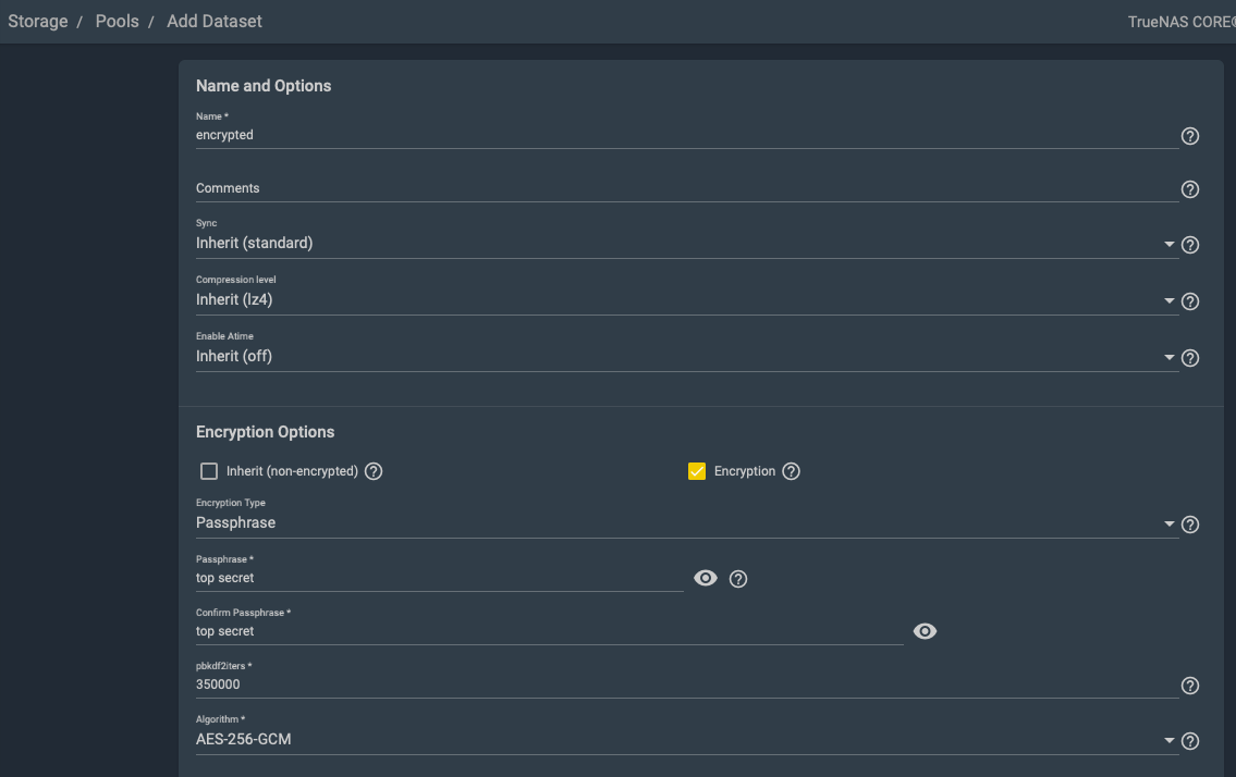

Encryption is per dataset now:
Patrick M. Hausen
Nov 25, 2013
7,776
You wrote "pool encrypt option" :wink:
So
  • encryption is per dataset
  • it can only be enabled at create time
How should ZFS go about encrypting a dataset full of valuable files after the fact? That would mean rewriting everything - and ZFS has a design policy to never rewrite data at rest. Device removal is already violating that, though.
9,700
Sounds like what you're saying (without actually spelling it out) is to create a new (encrypted) dataset and zfs send | recv into it, then optionally at the end, rename... I guess you could rename, create the encrypted one with the original name, then send | recv.
