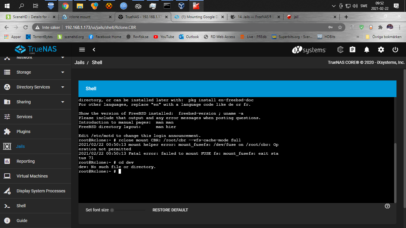

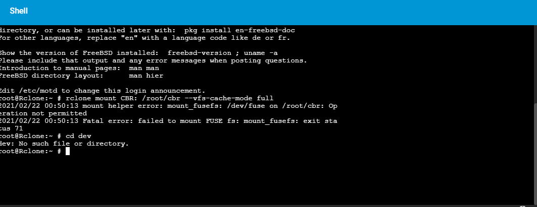

Tullk
Jul 22, 2020
3
I cant my rclone mount. Have tried the things you wrote about. Allowed fs mount, rulset to 0. But i get operation not permitted.
