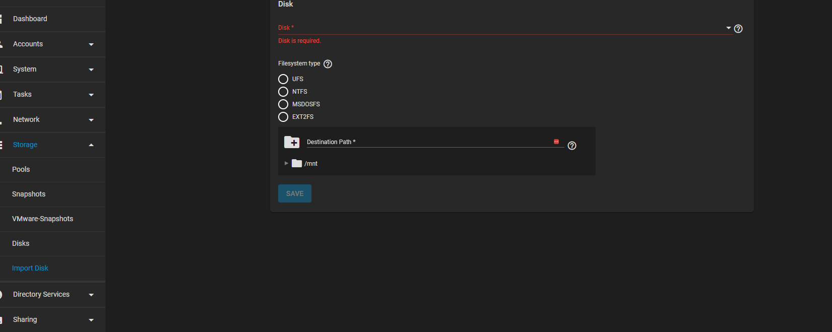

artlessknave
Oct 29, 2016
1,506
I've never tried it but this section is dedicated for this purpose
NASbox
May 8, 2012
650
Thanks, that worked. Now I need to get the drive unmounted. I'll start a new thread for that.
