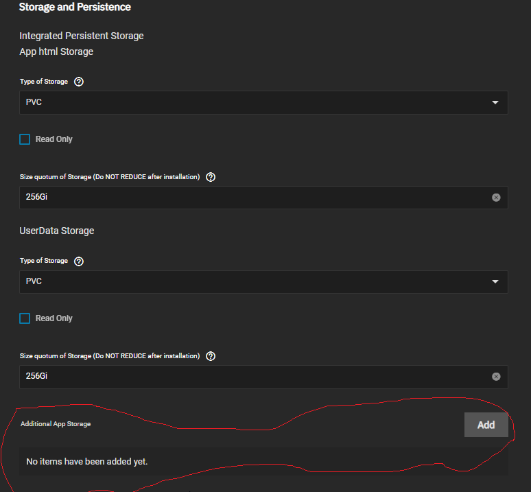

Hello all,
So I am looking to setup NextCloud so I can access my TrueNas Datasets from anywhere. I have installed NextCloud and have done reading on how to add external storage to NextCloud, but to do so I would need to install SMBCLIENT to TrueNas. However I have also seen people state adding a mountpoint to Datasets on TrueNas so they are accessible from within the NextCloud UI is better.
I have two questions .
1. If SMBCLIENT is the best way forward for adding my SMB shares into NextCloud, what is the best way to do that for TrueNas Scale ?
2. If using a mountpoint is the best way, could someone kindly provide some screenshot style instructions/reference ? I have spent some time googling for the answers and searching here but I could not find a clear or concise answer on how to get my Datasets mounted properly.
Many thanks in advance.
P

I can't get it work in Scale either however I managed it in Core. I think it is dataset and/or permissions issue. I will keep digging though
PackElend
Sep 23, 2020
60
are you talking about using additional app storage?
otherwise can you use https://docs.nextcloud.com/server/l...iles/external_storage_configuration_gui.html?
