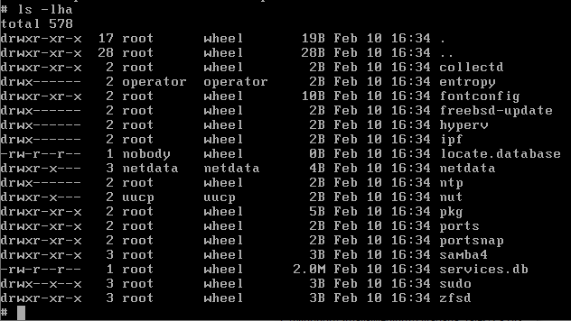

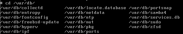

Chris Moore
Wizened Sage
May 2, 2015
10,062
gesshoku
Member
Jun 23, 2012
46
Thanks Chris. Unfortunately the folder "system" doesn't exist for me:
I will search further. I am pretty sure I made another backup last week....
And will also still contemplate booting a previous version.
