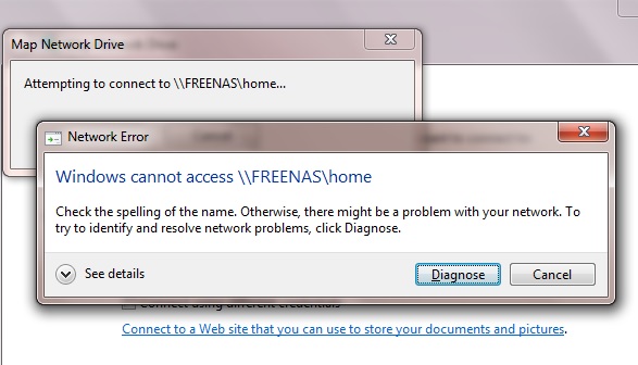

The restored share was fully functional for one day. It was allowing me to read and write. I shutdown the system and when I restarted the system today, I am unable to map my network drive. It is showing the attached message. I again deleted all shares, deleted all users, groups. and formatted the pendrive and reinstalled the freenas. When I booted up I configured the network and auto - import the volume. It was imported successfully. I created the user and the group. Did the windows CIFS share and in the volume set the permissions as Users = nobody , Group = Home, Set permission recursively = checked, as I did earlier and it worked perfectly fine under these settings. When I went to services, I see I cannot start the CIFS service. I restarted, but could not start the CIFS service.
I again tried to restore using the earlier configuration file after deleting all shares, users, groups and detached volumes. When it restarted, it showed CIFS service ON, but I cannot stop it. Even then when I tried to map network drive, it shows the message as attached. and in the Network places also, i cannot see FREENAS, as I have seen always.
Where is the Problem. Please guide me. I am stuck. I am surprised because, even after re configuring and reinstalling FreeNAS, it sud work perfectly fine, even if there was some corruption in the operating system. I can Ping...I can browse the admin page of FreenAS and do all changes, but why am I not able to map the network drive and why it is not showing in the network places.
Please guide.

gpsguy
Active Member
Jan 22, 2012
4,472
Previously, you had been using FreeNAS-9.2.1.2-RELEASE-x64. That's what I suggested that your restore to, in my earlier message. Did your install 9.2.1.5? If so, see message #14 in this thread, regarding a patch to fix the issue. Frankly, I'd just go back to 9.2.1.2 for now - the developers are working on 9.2.1.6, to fix more bugs.

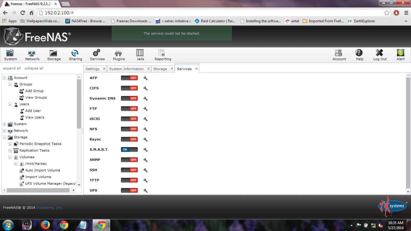

rahul
Jul 9, 2013
25
No..I have changed the pendrive. But stiil the problem exists...CIFS service could not be started...
Please guide to save the data..
rahul
Jul 9, 2013
25
I guess the CIFS service could not be started, that's why, I am not able to map the drive and also FREENAS have disappeared from My Network Places..But I can See my data folders, if I go to Add windows Sharings..Please guide, How to solve this problem.
gpsguy
Active Member
Jan 22, 2012
4,472
I read a message via my phone yesterday that discussed the same issue. another poster in that thread also mentioned having had the problem and his problem was due to not checking a CIFS setting. Now, I can't find that thread this morning.
See if you can find it. I have to go to work now.
gpsguy
Active Member
Jan 22, 2012
4,472
I found the thread, search for "CIFS won't start". Do you have the setting mentioned in post #4?
