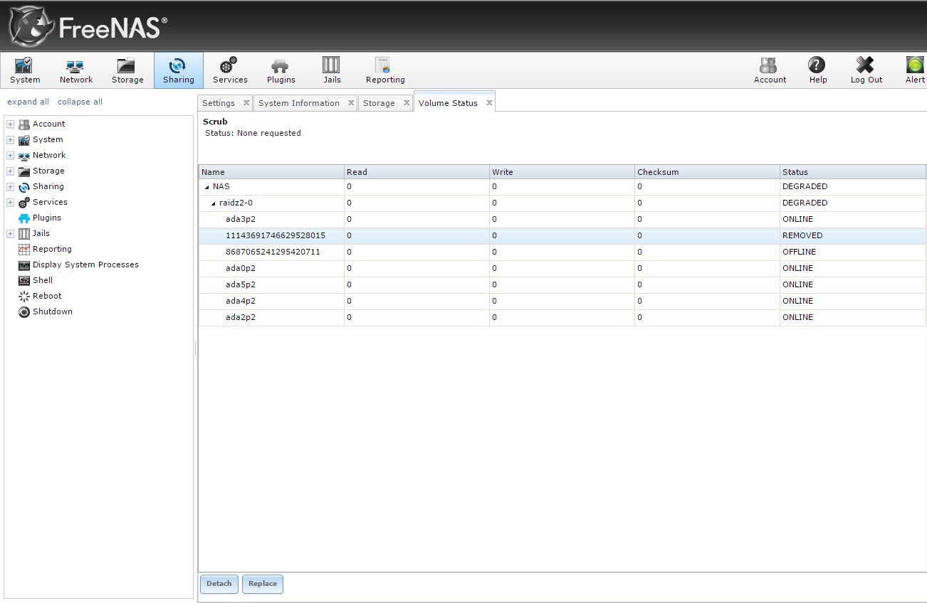

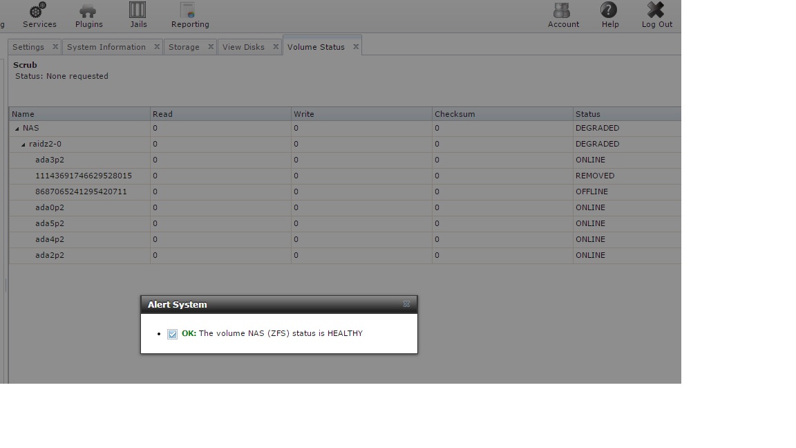

But you can see things are not happy yet.
And in the GUI I get mixed messages too...
If this is normal after a resilver the guide does not talk about it.
I feel like I just realized I'm standing on a frozen lake because I heard ice cracking under my feet.
What direction do I step next?

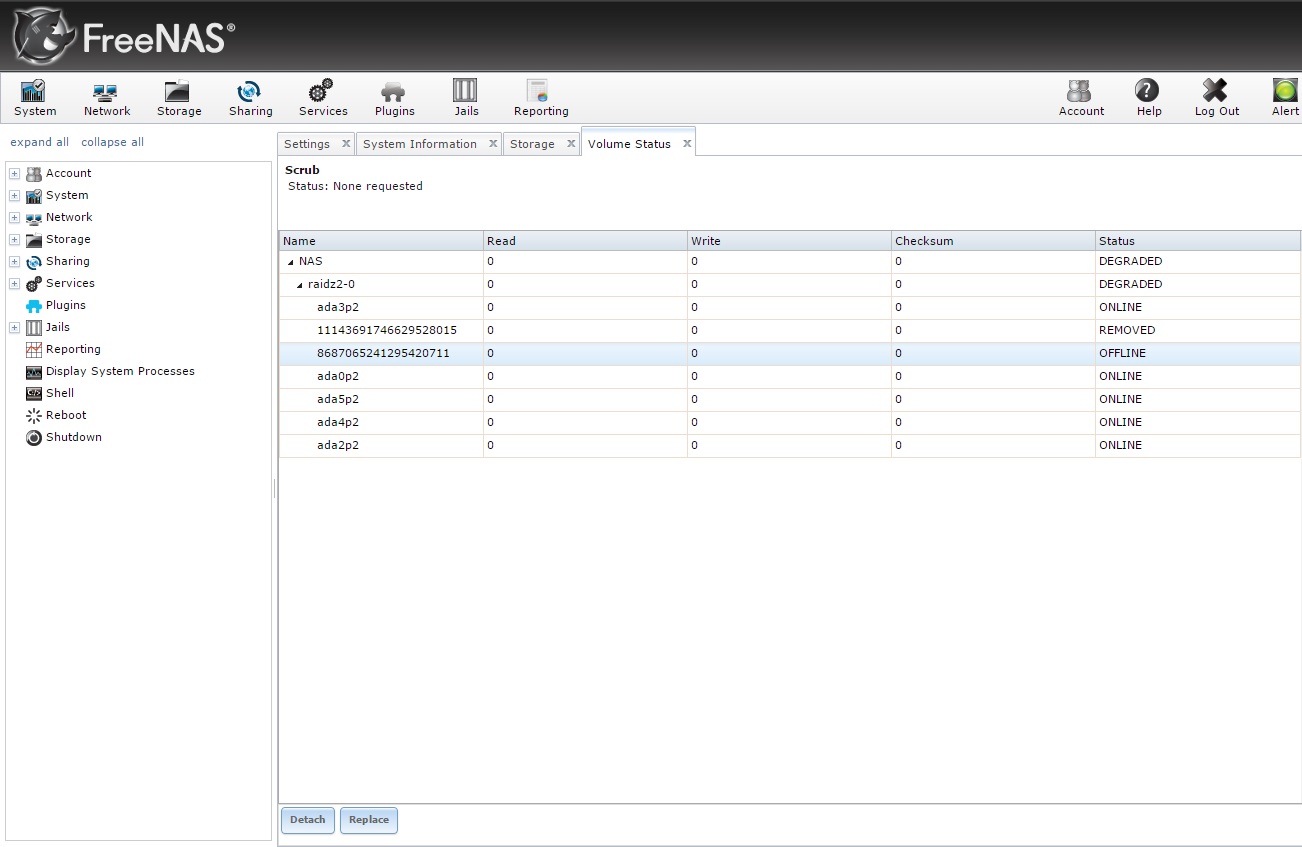

That depends on the current situation. Can you provide a screenshot with each of the two questionable drives selected, their status (removed/etc.), and the buttons at the bottom of the WebGUI?
climb2bhi
Feb 1, 2012
108
Gladly.
And:
I really appreciate your time and help with this.
Again I think I should have noted the Name number that was created as I went through the steps of the resilver.
The system only has 6 drives currently installed.
