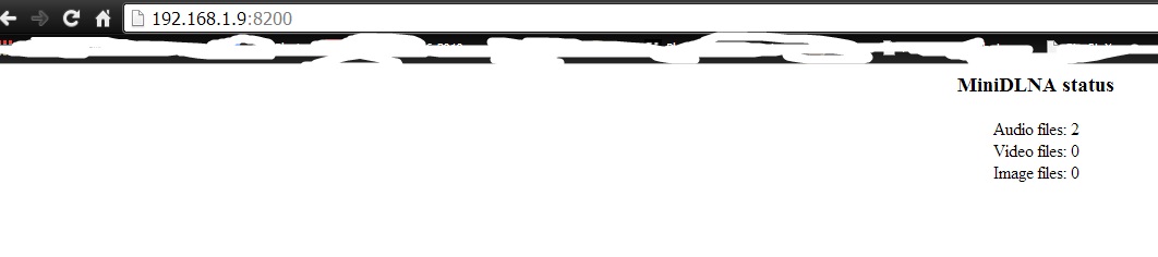

I have installed the MiniDLNA as mentioned above. I have mapped storage and put two music files under the storage.
When i execute 192.168.X.X :8200 i am able to see that the files are scanned and displayed as attcahed.
My biggest problem is none of the DLNA clients are able to display the server.
