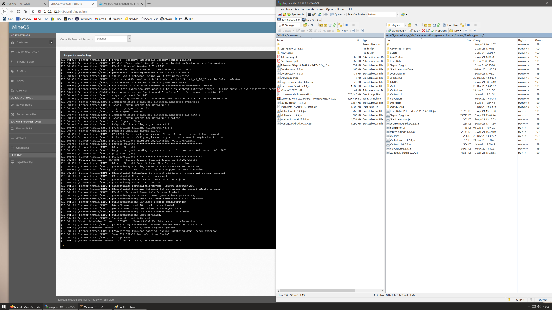

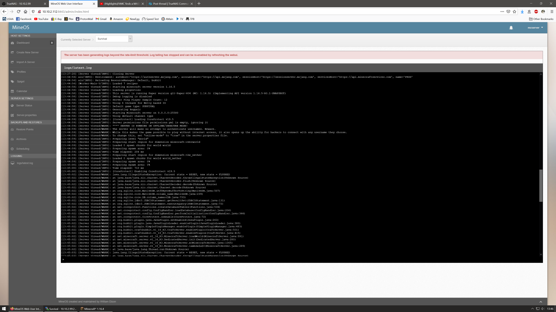

Gents,
I have been running a small Minecraft server in my FreeNAS11.3 server for some time now. It was a Paper server with about 10 plugins and has had no issues. I recently upgraded to TrueNAS 12 and all of my plugins and jails carried over no problem, everything worked fine. The only issue I had was none of my jails would upgrade through the GUI. Long story short, I uninstalled my jails and re configured them in fresh iocage jails. The only one I am now having an issue with is MineOS. Certain Minecraft plugins refuse to run properly. Namely Core Protect, Advanced Teleport, and World Guard. I have attached some pictures where you can see that removing those specific plugins will allow the server to start with out errors, but once the 3 are added, a lot of errors are thrown, and then the server halts.
I am really confused here. I know nothing about Java and was hoping someone could point me in the right direction.

OK, I tried to reproduce this, I installed the MineOS plugin with default settings (NAS) on TrueNAS CORE 12.0-U2.1.
No issues with the plugin itself. In the MineOS UI, I downloaded the papermc 1.16.5 profile ("Paper-1.16.5-latest") as that's the one I remember seeing in your logfiles and created a new server called paper.
In the jail, I tweaked the install:
service mineos stop
pkg install sqlitejdbc
pkg remove openjdk11-jre  # because sqlitejdbc uses openjdk8
# copy CoreProtect-19.5.jar to /var/games/minecraft/servers/paper/plugins
service mineos start
Back in the MineOS UI, I started the paper server. I get the same messages as in your screenshot.

That being said, these JDBC and sqlite messages are logged as warnings, not errors. After all this, it states CoreProtect has been successfully enabled!
Not sure how to use CoreProtect, but when I type the following in the console plugins, co, co status this is the output:
[22:06:02] [Server thread/INFO]: Plugins (1): CoreProtect
[22:06:07] [Server thread/INFO]: ----- CoreProtect Help -----
[22:06:07] [Server thread/INFO]: /co help <command> - Display more info for that command.
[22:06:07] [Server thread/INFO]: /co inspect - Turns the block inspector on or off.
[22:06:07] [Server thread/INFO]: /co rollback <params> - Rollback block data.
[22:06:07] [Server thread/INFO]: /co restore <params> - Restore block data.
[22:06:07] [Server thread/INFO]: /co lookup <params> - Advanced block data lookup.
[22:06:07] [Server thread/INFO]: /co purge <params> - Delete old block data.
[22:06:07] [Server thread/INFO]: /co reload - Reloads the configuration file.
[22:06:07] [Server thread/INFO]: /co status - Displays the plugin status.
[22:06:16] [Thread-16/INFO]: ----- CoreProtect -----
[22:06:16] [Thread-16/INFO]: Version: CoreProtect v19.5.
[22:06:16] [Thread-16/INFO]: License: Invalid donation key. (Please check config.yml)
[22:06:16] [Thread-16/INFO]: Database: Using SQLite. (Initial DB: 19.5)
[22:06:16] [Thread-16/INFO]: Consumer: 3 items in queue.
[22:06:16] [Thread-16/INFO]: Discord: www.coreprotect.net/discord/
[22:06:16] [Thread-16/INFO]: Patreon: www.patreon.com/coreprotect/
Do you get this far?

Yes, I get that far as well, but once you restart the 1.16.5 instance again, It crashes during start up. If you then delete the coreprotect data, It will start with warning the first time, and crash at every other restart.

Same issue, except I run java 16 due to many plugins requiring it now. Still crashes due to sqlite errors

I did, issue seems to be with sqlite-jdbc
Only get errors with java plugins that try and use sqlite databases, if you change it to use mysql there are no issues
