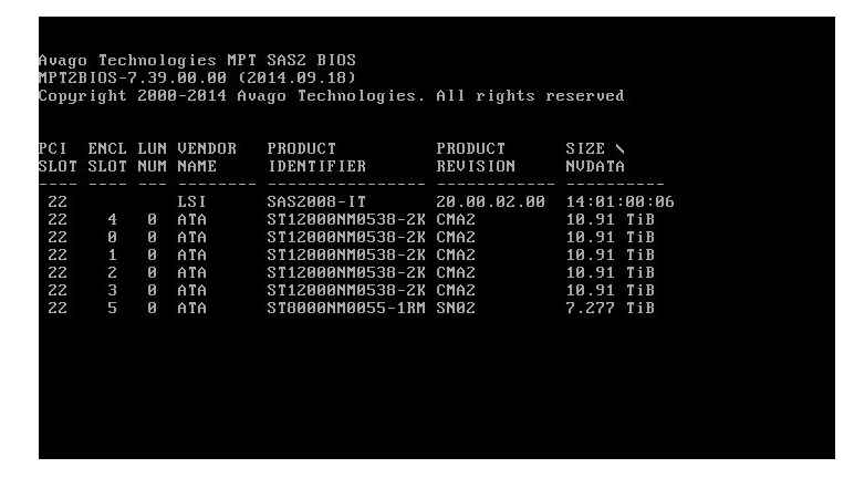

when i boot, i can see that the raid card detects the drives:
however, in trueNAS, I cant see them at all when i go to the disks section. the 5x 12TB were from the synology. the 8TB is an NTFS formatted drive used on a usb sata dock.

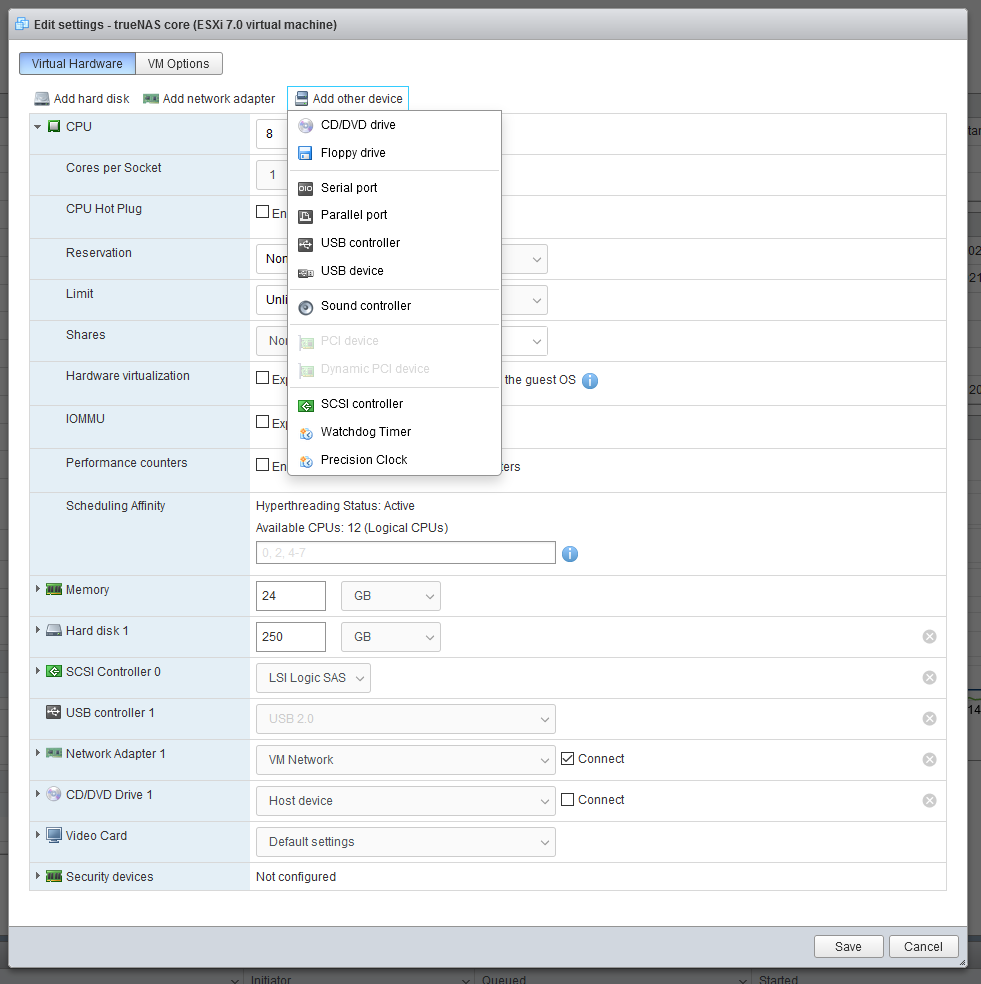

in eSXI, under the trueNAS vm, i see the controller listed:
i am not sure what i am doing wrong. any help?

Are you passing the LSI card in with PCI passthrough? (it doesn't look like you are)
Without that, you shouldn't see the disks.

@sretalla sorry for the late reply. i spent a few days trying to figure this out without luck. I cant seem to add the LSI card with PCI passthrough. The option is greyed out and i do not know why.
as you can see, i have "expose hardware assisted virtuation to the guest OS" disabled. Are there any other settings, possibly in the BIOS, that i need to enable / disable in order to get this working?
