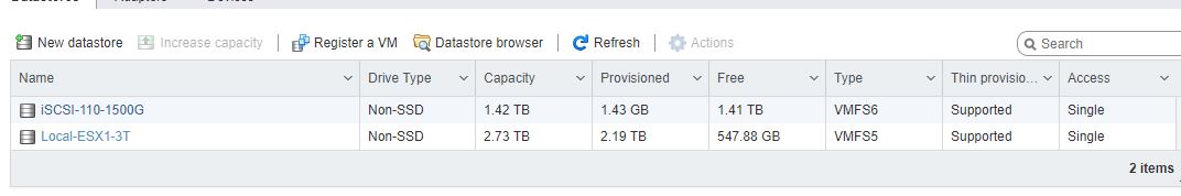

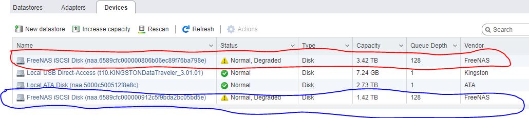

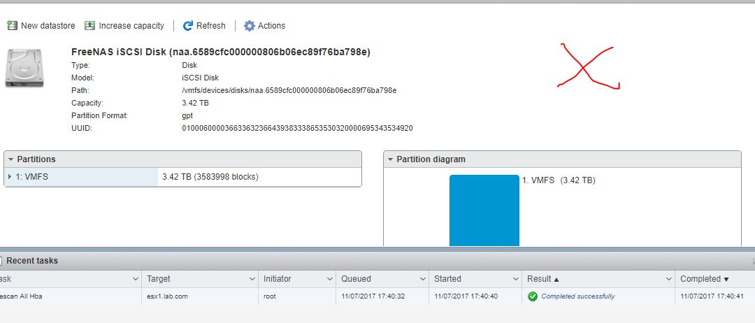

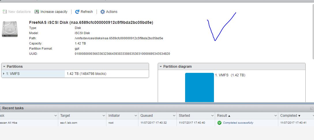

from below screenshoot, seems there is nothing difference between the newly created iSCSI Lun (1.42T) and the problematic iSCSI Lun (3.4T). Using esxi 6.5, a bit different from what you mentioned above.
3.4T should be seen by ESXi per screenshoot and ESXi SSH output, but it probably is not mounted. In the past I add new datastore , see the LUN and assign new signature, it then works. not this time. still no luck.
