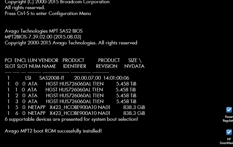

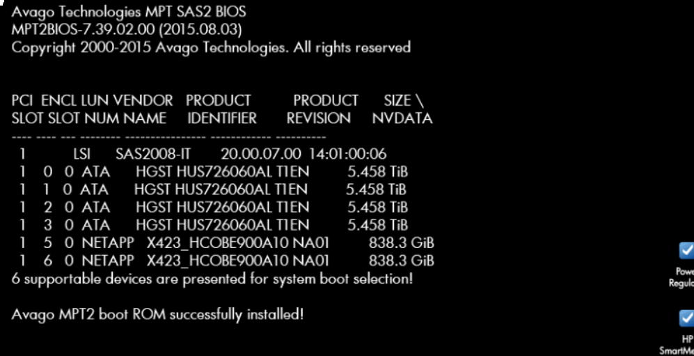

ops! I see more forum posts from various users who use it. Without having more detail of possible problems, of course
I have LSI SAS2008 IT

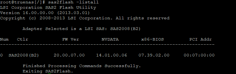

You need to clarify whether it is a HBA or a RAID controller, and which firmware it runs.
sas2flash -listall should give the anwser.
The issue arises equally for XigmaNAS.

It's a RAID controller. If it were an HBA, it would say IT instead of B2.

Really?
root@truenas[~]# sas2flash -listall
LSI Corporation SAS2 Flash Utility
Version 20.00.00.00 (2014.09.18)
Copyright (c) 2008-2014 LSI Corporation. All rights reserved
    Adapter Selected is a LSI SAS: SAS2308_1(D1)
Num   Ctlr            FW Ver        NVDATA        x86-BIOS         PCI Addr
0  SAS2308_1(D1)   20.00.07.00    14.01.00.06    07.39.00.00     00:03:00:00
    Finished Processing Commands Successfully.
    Exiting SAS2Flash.
