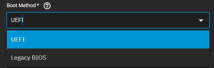

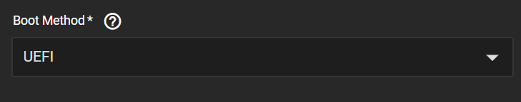

Were your VMs UEFI boot to begin with? If they were BIOS you need to make sure its BIOS now. If it were UEFI you need to make sure its UEFI now.

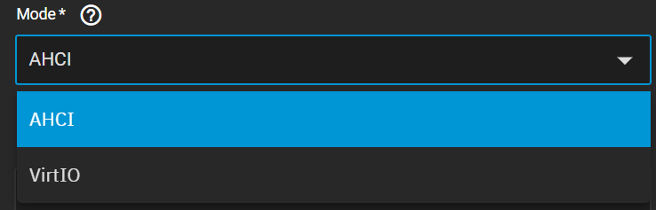

What did you try for your SCSI driver? You'll probably be stuck with the LSI emulated "AHCI" one for now.
Some combination of those two things will help you get them going. I just don't know what you did before to be more specific.
