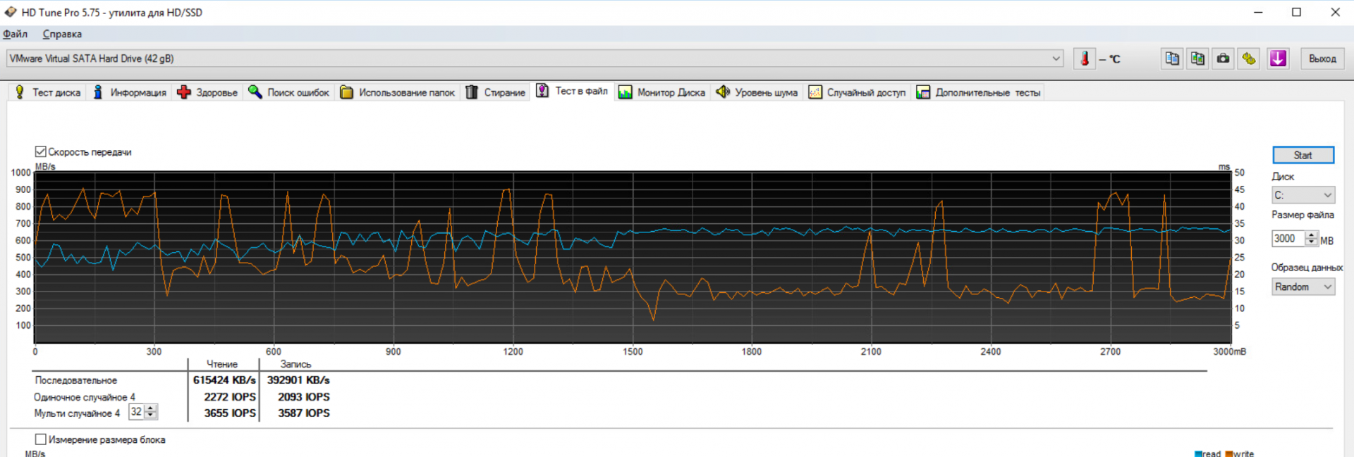

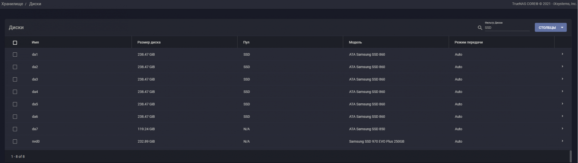

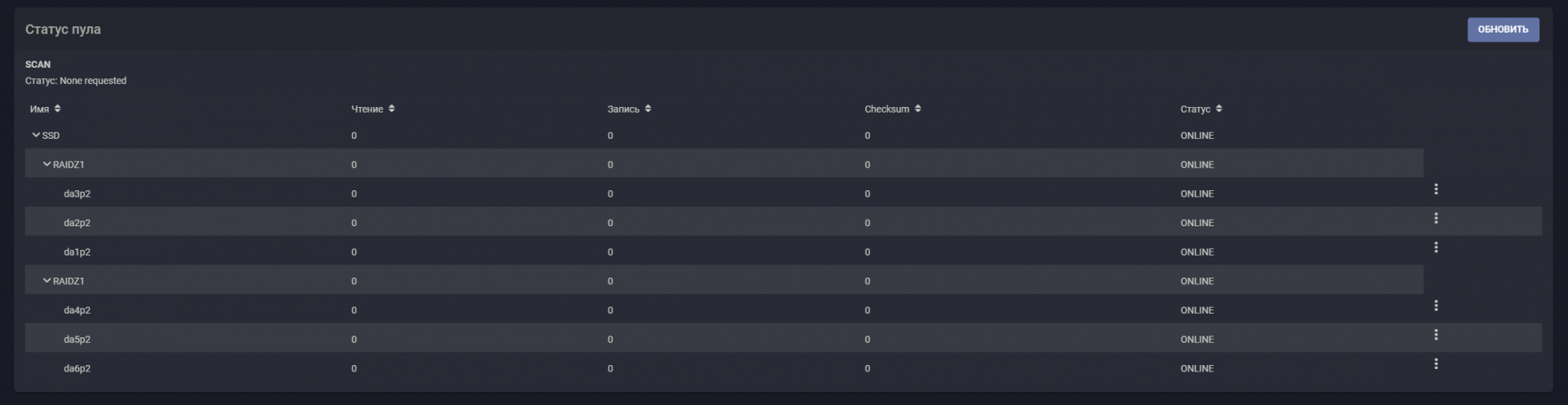

Im replace controller to LSI HBA 9207-8i, but I see a strange result on the speed of reading from the pool SSD (11111)
any idea?

And what strange result would that be? It's not giving you a flat line?
In general, the more things that get introduced between the actual storage device and the consumer, the more variability you're going to get in reported performance. Even a SSD directly attached to a real PC generally doesn't give you "flat line" performance, and here you've got what I'm guessing to be a ZFS based NAS connected to a hypervisor over the network sitting in between.
If you believe that your setup should be capable of more, the traditional way to deal with this is to look at each subsystem individually and make sure the basic elements are all performing as well as they can -- a chain is only as strong as its weakest link. For example, using a RAIDZ1 pool to store VM block data is a bad idea;
https://www.truenas.com/community/threads/the-path-to-success-for-block-storage.81165/
you won't be getting all the benefits of parallelism and may be running into some other issues with RAIDZ. Then, when you've made sure that each subsystem is optimal, it becomes easier to look at the bigger picture to see if there are any meta-problems that may be causing performance issues.

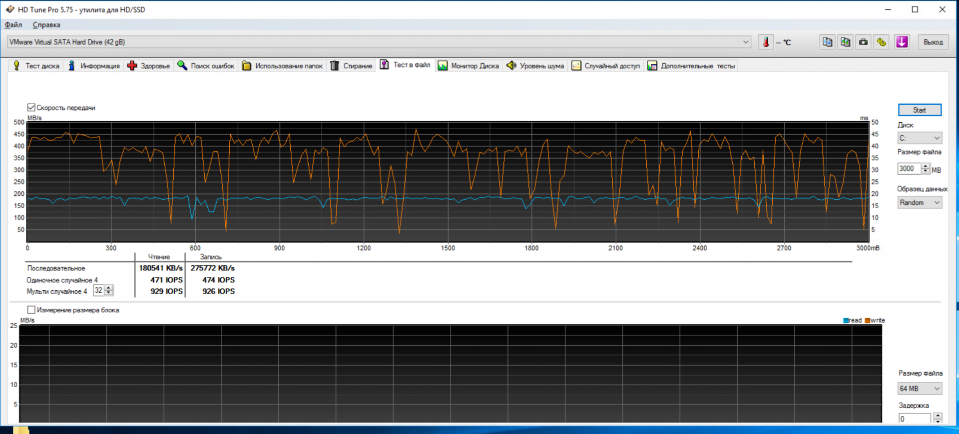

my problem is in the blue line, it is only 200 megabytes per second, if I make a pool from one disk, then it shows 600 megabytes per second (44444), this is strange

hw.pci.honor_msi_blacklist=0 in loader.conf resolve my problem
