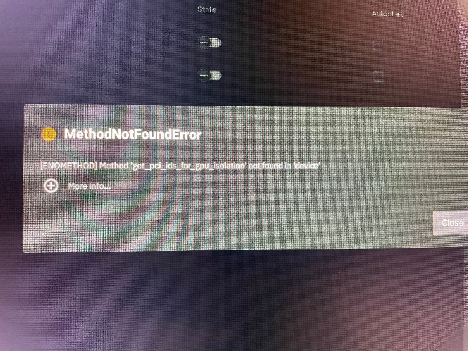

Method 'get_pci_ids_for_gpu_isolation' not found in 'device'
Dec 30, 2023
7

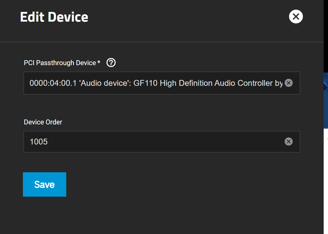

Hi, I found a solution, you have to add the necessary PCI slots for your GPU under Devices.
In my case once for the GPU (GTX 1050ti) and for the audio controller.
If anyone needs step-by-step instructions, please let me know.
Hi, I cannot confirm that this works. I tried it several times and even tried to pass through the dedicated graphics card with a new VM.
Of course, I also switched the existing VM offline.
And set up a Windows 10 as a test.
In your case, the parameters seem to be different.
I also noticed that I can no longer change the RAM in the existing VM. TrueNas confirms my “change”, but it is not even applied.
I also suspect that there is a serious bug here, sorry, I'd rather wait for a clean fix before a “workaround” causes me even more problems

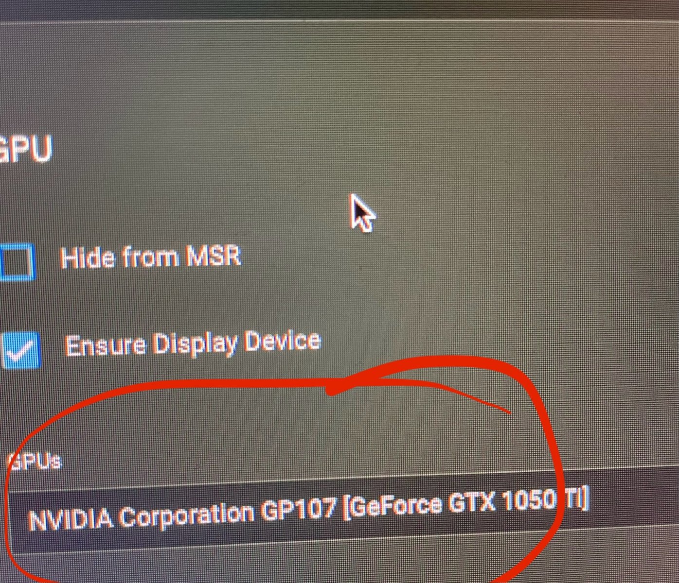

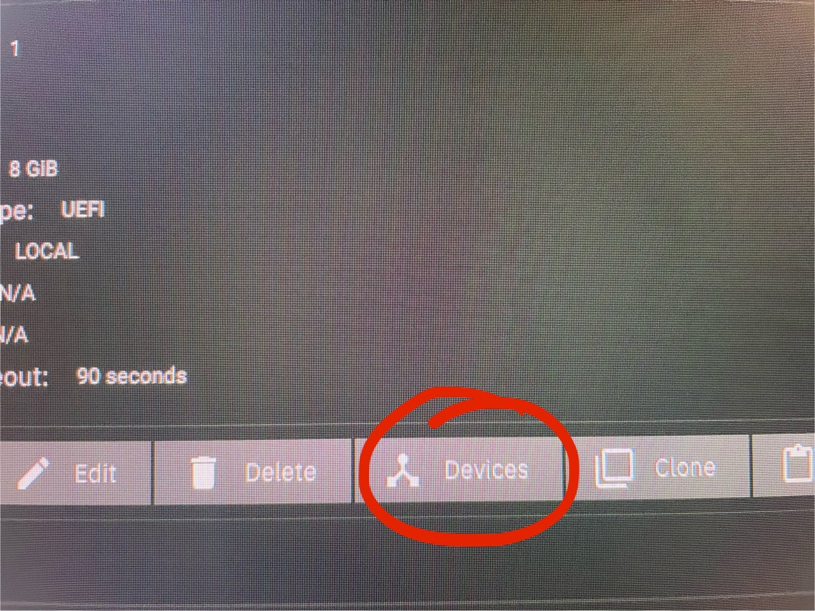

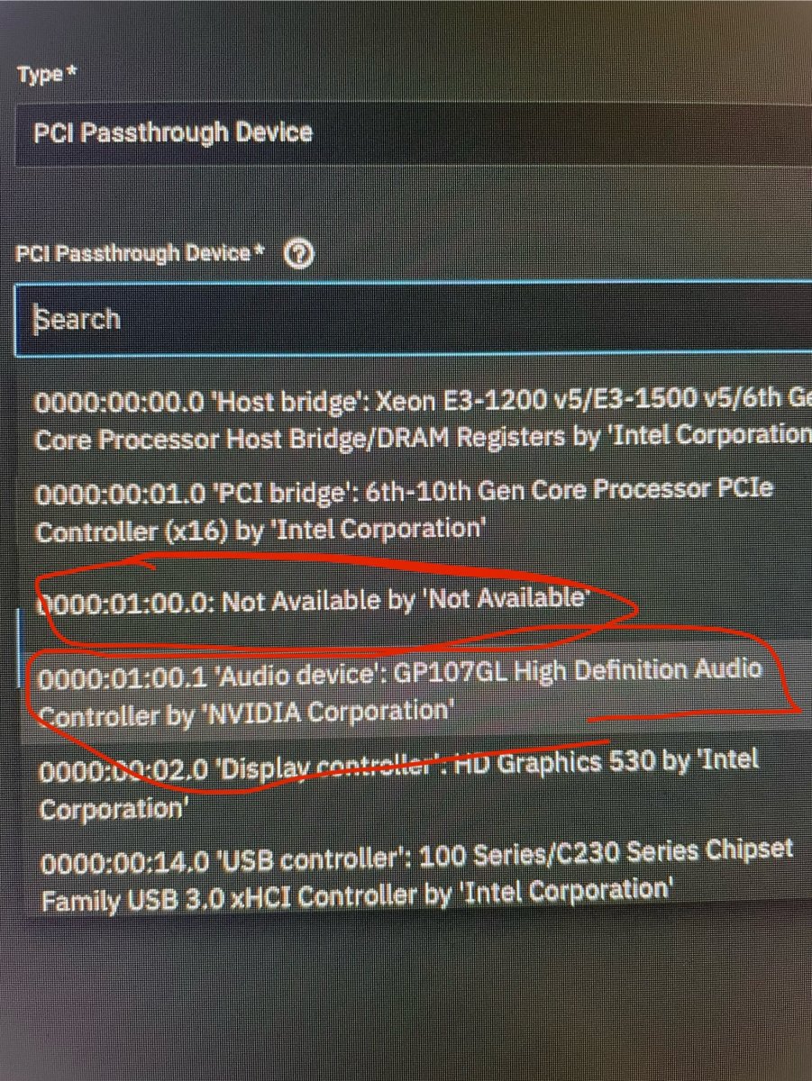

I’d appreciate a guide to the solution. Anybody else notice that once a virtual machine is created as well, you can’t edit any of the properties? The save just fails to save. Seem like a huge bug.
Step by step troubleshooting guide:

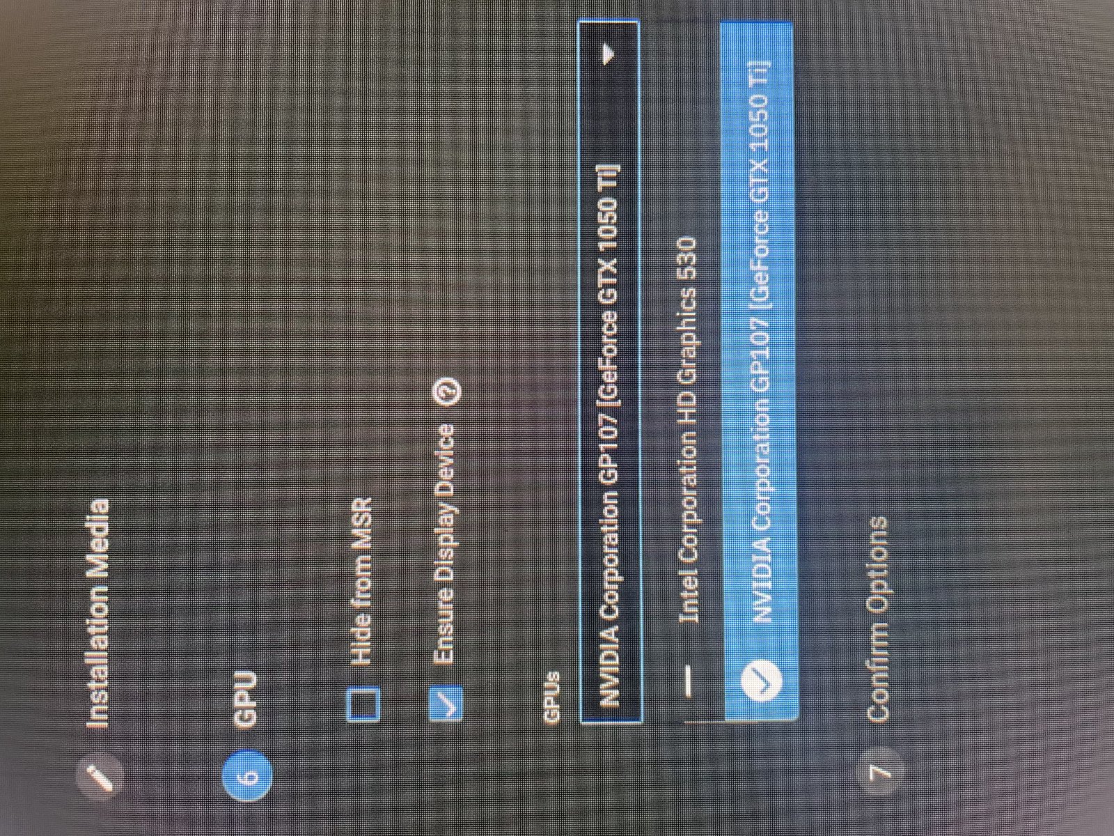

1. Create a New VM as usual
2. Add your desired GPU
3. Click next and save the VM
4. Close the error message and the window for creating the VM

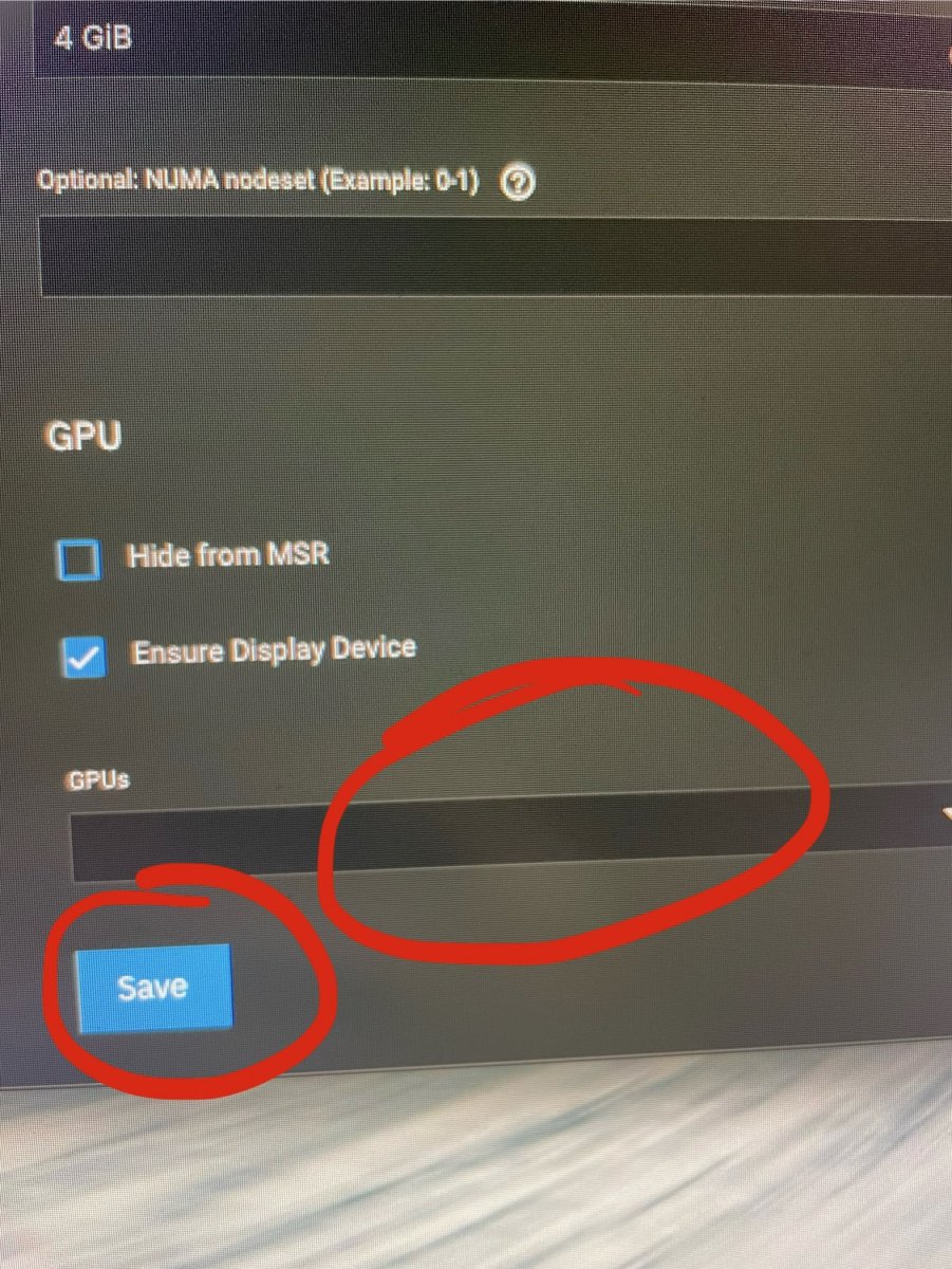

5. Click edit on the newly created VM
6. No GPU should now be entered
7. click save again

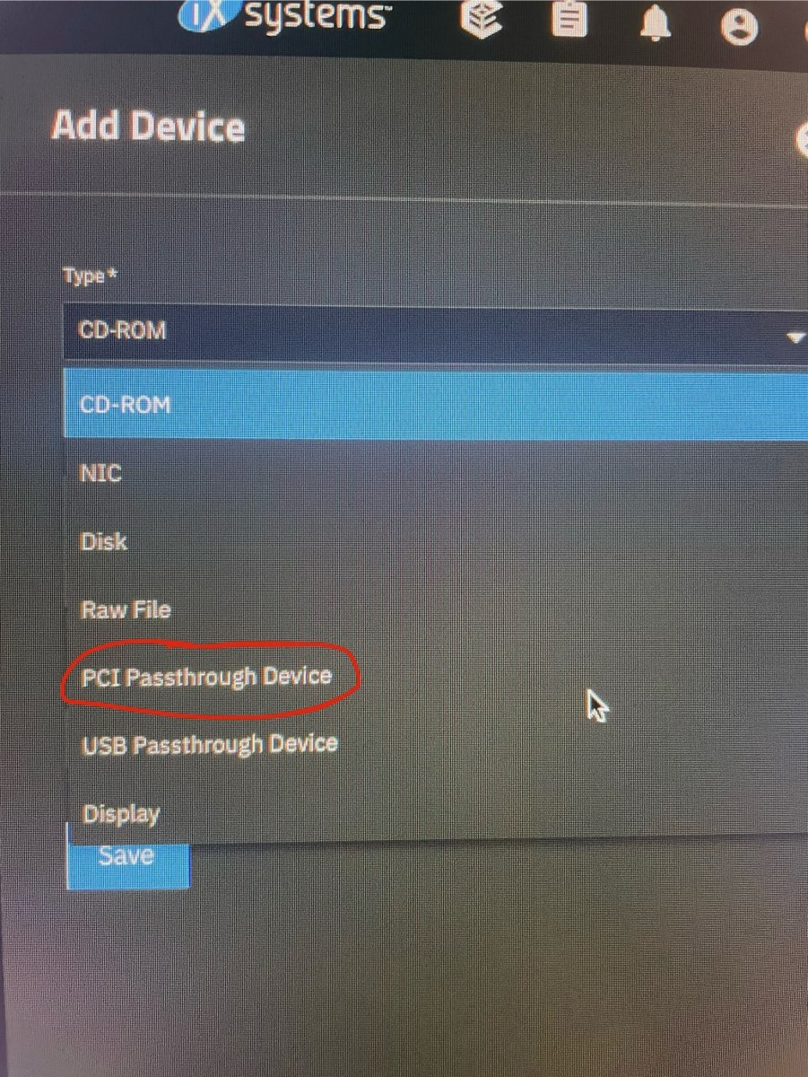

8. Now click on device

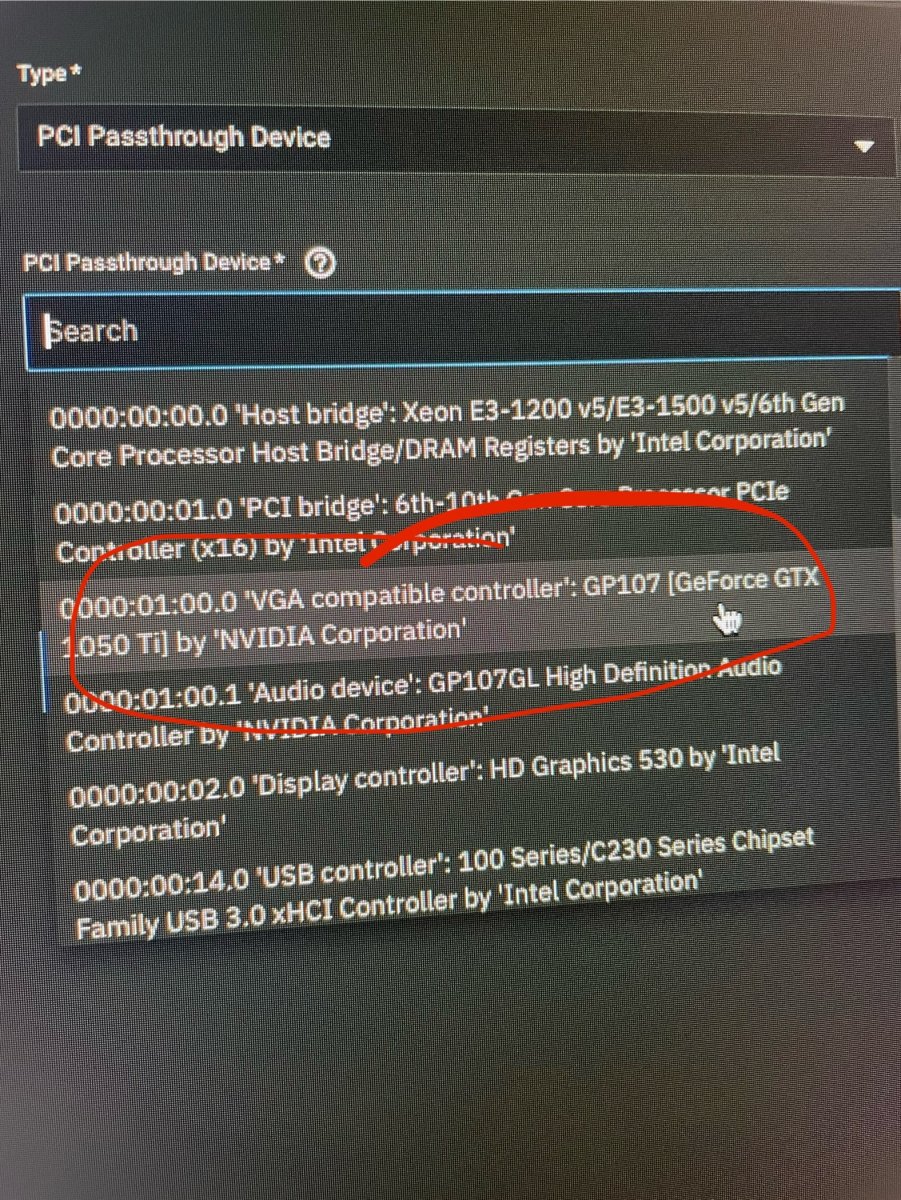

9. Now add a new PCI passthrough device here
10. Now look for your graphics card (in my case Nvidia), if like me the device is Not Available on port 0000:01:00.0, first save the available device (in my case the controller for the card's audio)

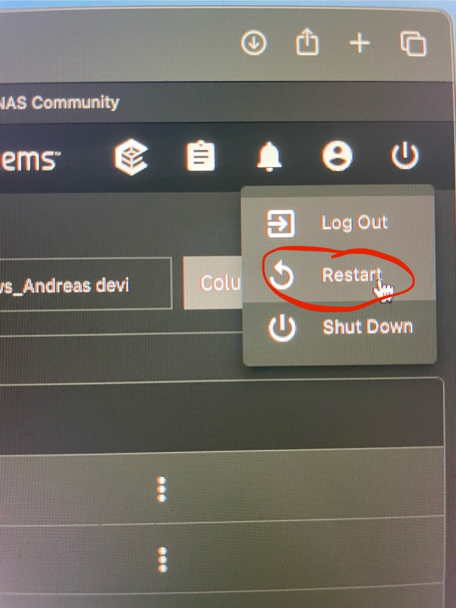

11. (optional if step 10 worked completely) restart your entire system
12. (optional if step 10 worked completely) go back to the device after restarting and now add the VGA to your GPU for PCI.
13. done, now the GPU should be entered, !!!if you change the GPU settings you have to repeat all steps!!!
I hope that it works now, I would be very happy about any feedback, whether positive or negative ;^)

Then I expressed myself incorrectly.
The GPU can certainly be activated in an existing VM, as in your "workaround", but I cannot change any RAM memory here. As soon as I try this, TrueNas displays - executed. However, the GPU has been lost, so as with your workaround, I have to mount it again, then start the VM and you can see that the RAM has remained the same.
I have enough RAM memory.
I can no longer set up a completely new VM after the update to 23.10.1.
Then I only get this error and setting up the GPU after this workaround is no longer possible.
I think a downgrade with the bug is too risky, you don't know which parameters might be destroyed.
Nevertheless, I hope that TrueNas itself has created a fix soon.
