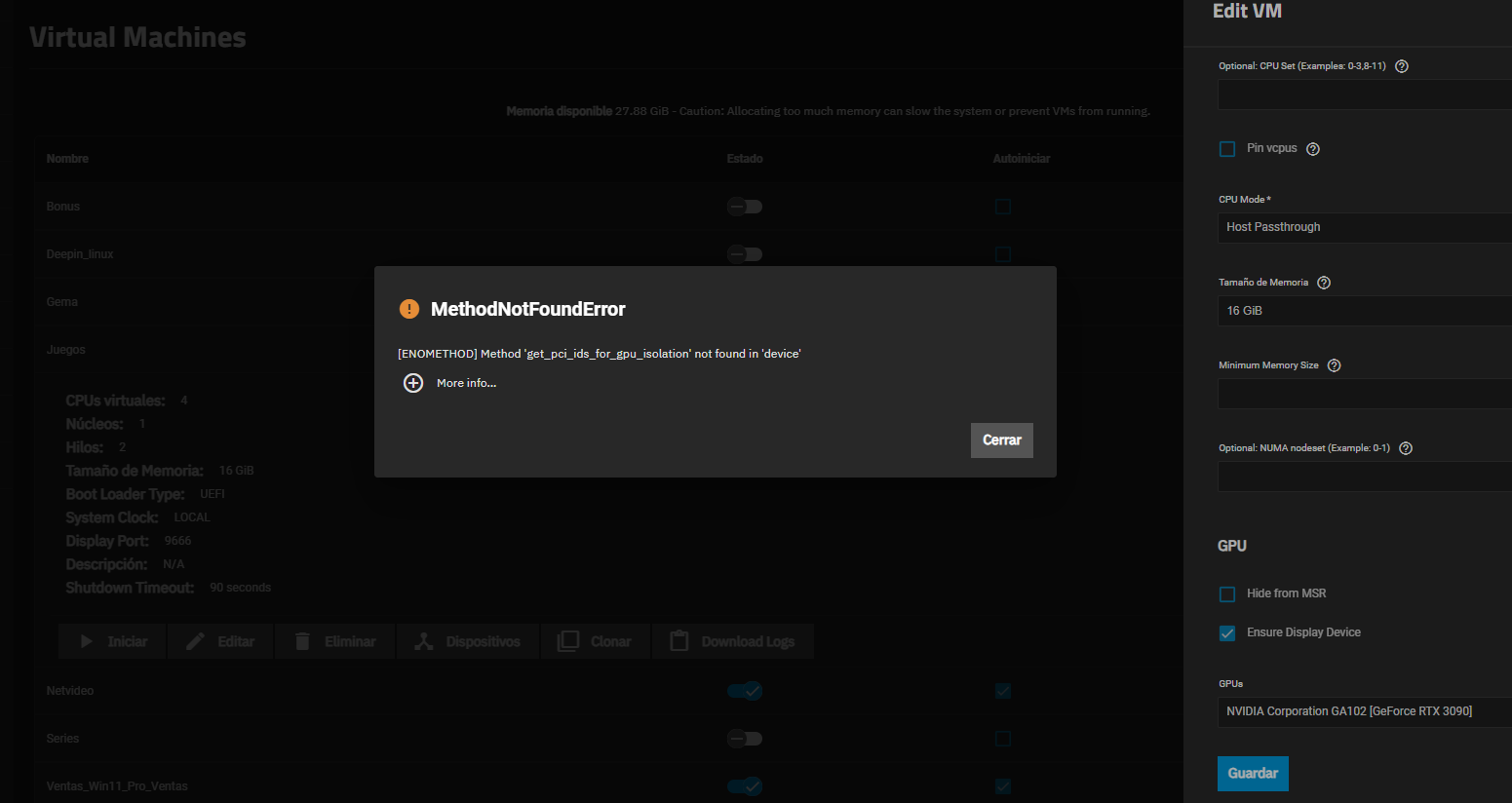

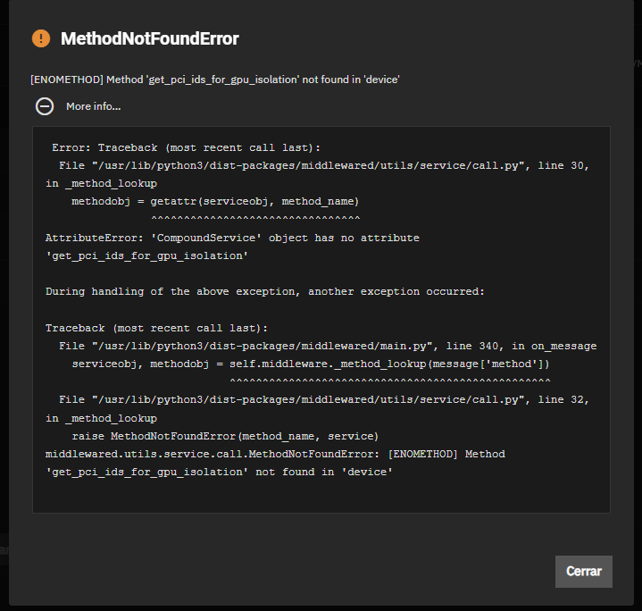

Since I updated, I have this problem when putting a gpu in a vm

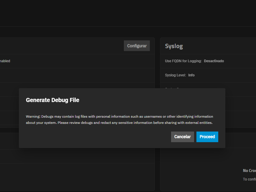

Suggest a bug report for this one, we'll need a debug file so we can review why its throwing that error.

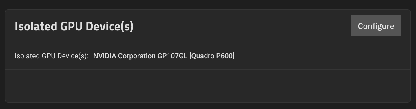

Hi, I have the same problem.
Came here to post the same screenshots.
I also isolated the GPU, which makes no difference.
Still broken.

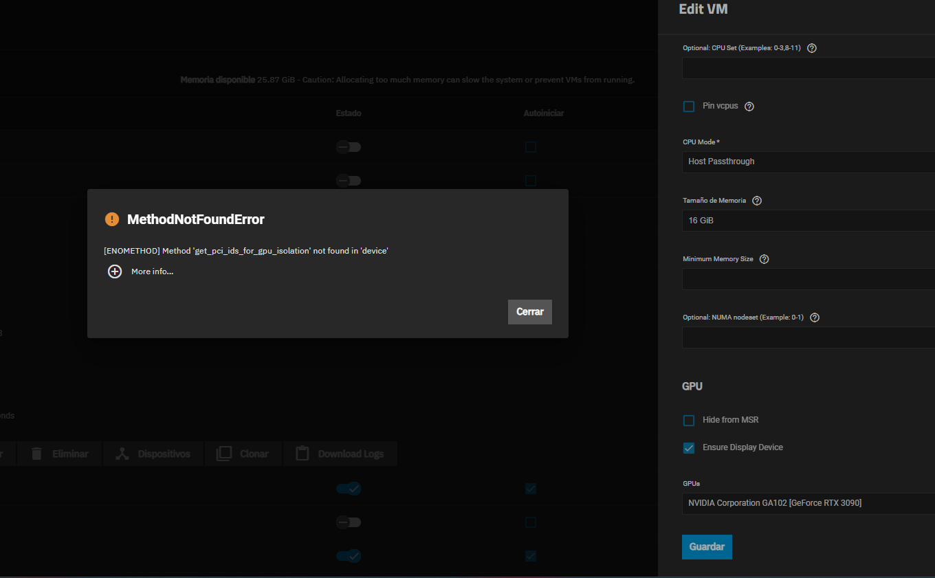

Another problem with this method is that if I want to change a VM parameter such as vcore or ram, it gives the same error, so I have to delete the gpu from the pci options, modify the vm, and add the gpu again
Full disclosure I do not work for ixSystems. I'm just a user like you. My solution is not elegant, nor am I happy with the lack of support for this in Cobia when it looked like Cobia was stable.
Yes, if you apply the PCI devices you can't change other settings without getting the error again. I actually needed to use the CLI yesterday to make changes to CPU resources even after I removed the GPU/PCI passthrough. I agree, this is not ideal but at least it's working. Hopefully they address these issues soon.

after the latest update, I have exactly the same error.
The explanation manually performs the graphics card via device's PCI passthrough goes.
However, the following functions no longer work with an existing VM. Changes RAM. I have tested my VM from 16 GiB to 20 GiB (enough RAM is available) Truenas confirms the change but nothing is changed.
Inserting a dedicated graphics card via the corresponding settings does not work, the error named and illustrated here is displayed.
The attempt to set up a new VM - a Windows 10 as a test - also does not work.
Apparently something happened to the VM level after the update to Truenas-Scale 23.10.1.

I'm having this exact problem with a 4060ti. Trying to pass it through to a single Windows 11 Virtual Machine using the latest version of TrueNAS Scale but getting "[ENOMETHOD] Method 'get_pci_ids_for_gpu_isolation' not found in 'device'".

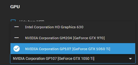

afach_luc
Jan 7, 2024
9
Hi, I found a solution, you have to add the necessary PCI slots for your GPU under Devices.
In my case once for the GPU (GTX 1050ti) and for the audio controller.
If anyone needs step-by-step instructions, please let me know.
