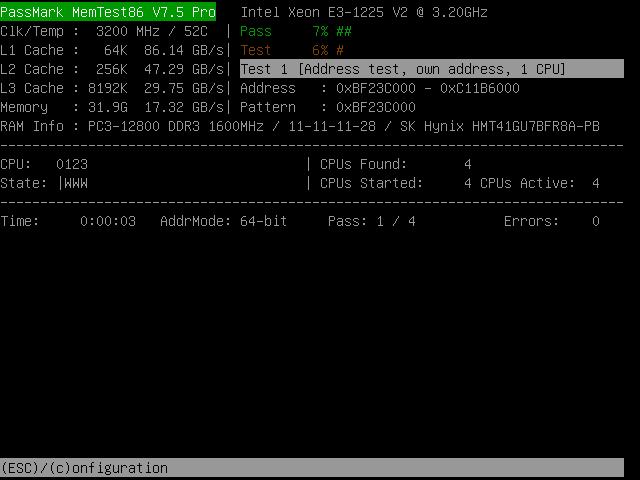

Hi all, I have a box on which I recently upgraded the motherboard & RAM via eBay as my old gaming ITX mobo capped out at 16GB. Unfortunately, right after all my jails came up the box would panic and die. So I did the obvious thing and ran MemTest86 (v7.5). Funny enough, it freezes almost instantly (in Test #1) once the test starts. Over the last few days I've been testing the DIMMs individually to try and determine what's going on. It appears the crashes only happen when all four DIMMs are installed. Every DIMM individually and pair-wise pass the test suite without issue.
The memory in use is listed on Supermicro's list of compatible memory. The only other fact I have been able to determine is it seems the test suite fails in different spots depending on the order of the DIMMs. I will be performing further test iterations to see if this yields anything useful.
At this point I'm not sure how to proceed. I'm open to suggestions as at this point I will just have to return both if I cannot get this figured out.

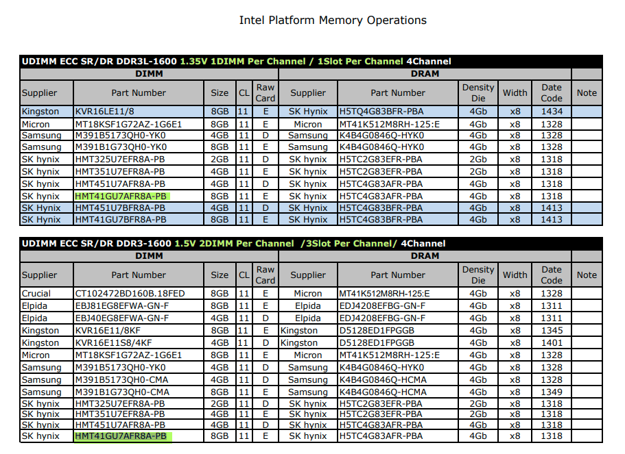

the following helped me in the past when i had similar problems:
  • taking mobo,cpu,ram apart > properly dust clean it > cleaning contacts gently with isopropyl alcohol > put everything back together
  • trying a different PSU
  • complete power off with power cables removed and BIOS battery removed for min. 8h
and as last option
  • raising RAM voltage. your modules are specced with 1.35V, increase in 0.05V steps up to max 1.50V if BIOS supports it.
edit:
An intel document on memory validation for a E5-2600v2 CPUs suggest raising voltage from 1.35V to 1.50V when using 2 of your DIMM modules "HMT41GU7AFR8A-PB" per channel. this is a strong indicator that you should do the same. ;)
See attachment too.

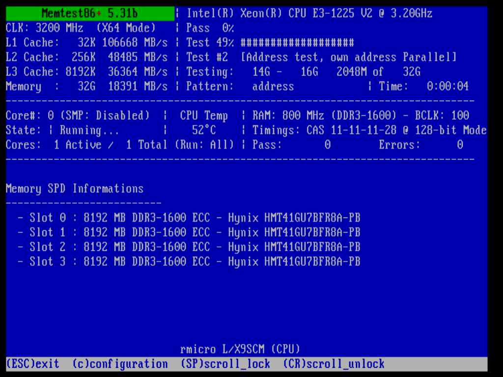

Okay, so reexamining all the BIOS settings that I flip (datetime, boot, aes-ni, and vt-d), the issue appears to be VT-d. Enabling that causes the lockup in memtest.
Taking Ericloewe's advice I also tried memtest86+ v5.31. It fails with and without VT-d enabled. It's a bit harder to grab since it crashes and reboots but I've attached the roughly last visible frame from the run. So this didn't give any more useful information.
> 1.35V DDR3 is also rated to run at 1.5V
I didn't know that, that's good to know! In this case it may not matter if voltage were an issue since the X9 bios doesn't allow one to tweak voltage.
At this point, the question is: Why might enabling VT-d in my motherboard cause memtest/kernel panics?
