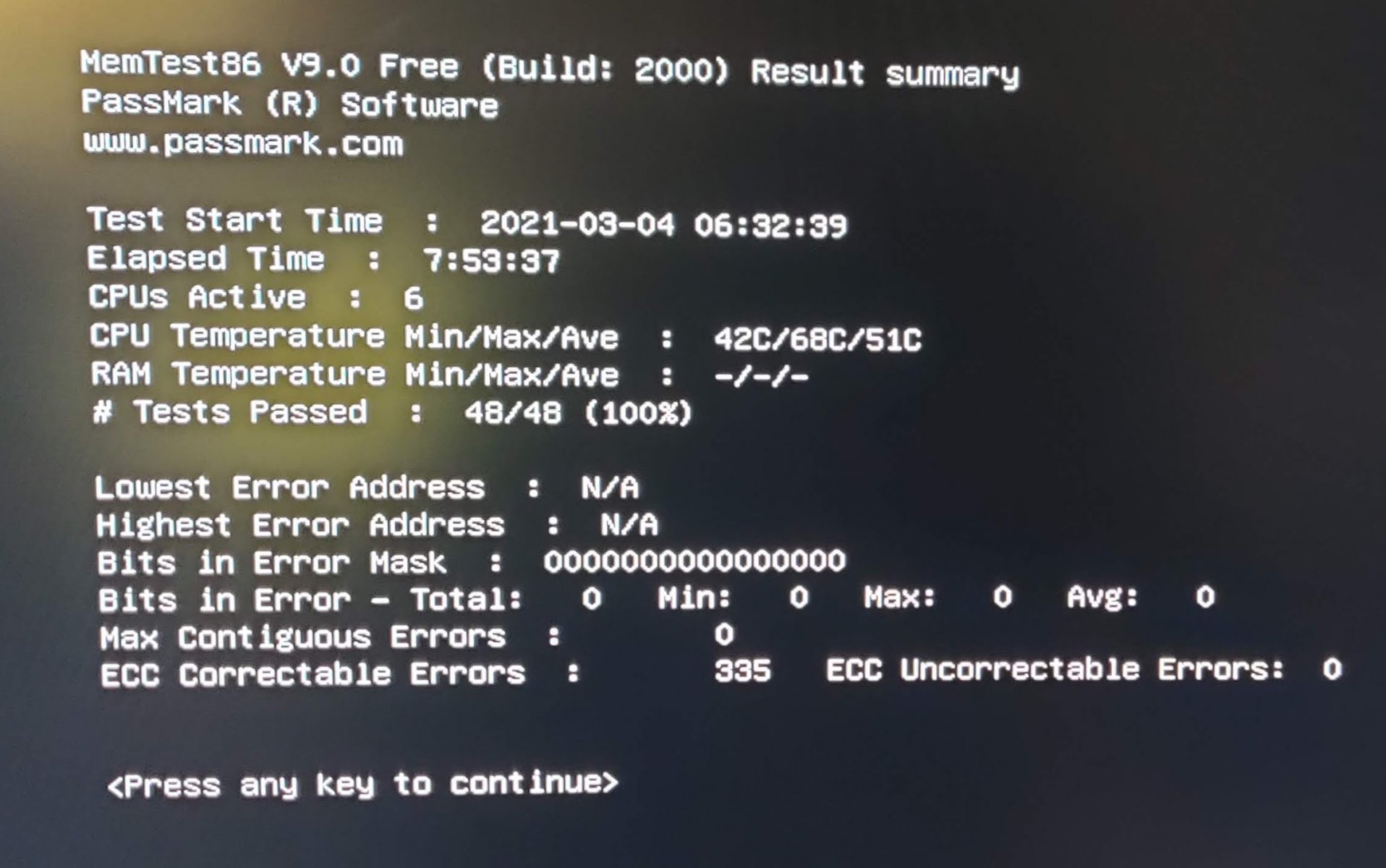

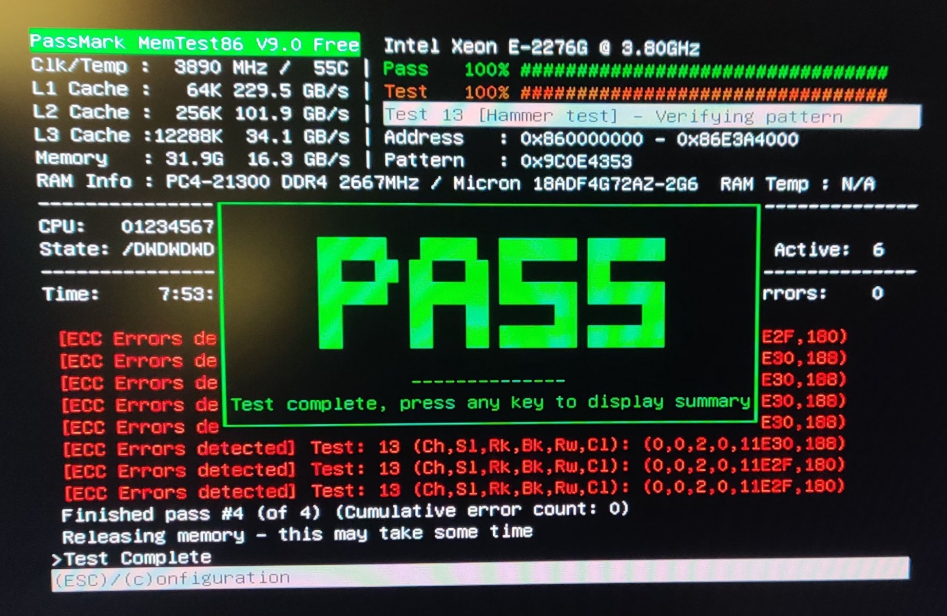

I was able to run the latest MemTest86. It passed, but it is reporting a lot of ECC correctable errors. Is this normal and just due to the memory being stressed during the test?

No errors would be typical. One error could pass as ECC working as it should. So many errors is an issue. Check that all modules are well-seated (possibly swapping them) and rerun the test.

That is not good :| I only have the one memory module. I'll check that it is we'll seated and run the test again. If it continues with many errors is there anything else I could try or should I just return the module?
