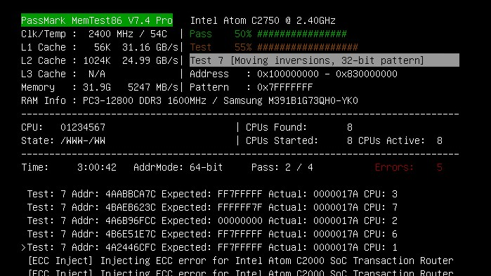

Memtest crashed on Pass 2/4 with 5 errors:
Following @joeschmuck's "rules" kindly stated earlier in this thread, we have DIMM1, Bank 0, likely in the second blue slot. So, for the next step I'm going to pull all the memory and put the suspected stick in the first priority slot, run dmidecode again the check the serial number, and run memtest just on this stick for starters.

MemTest86+Pro $35 with updates for 6 months. But only way to get error injection for ECC.
Looks like your memory mapping was right on the money - thanks once again.
Just starting memtest again with the suspect stick only...
