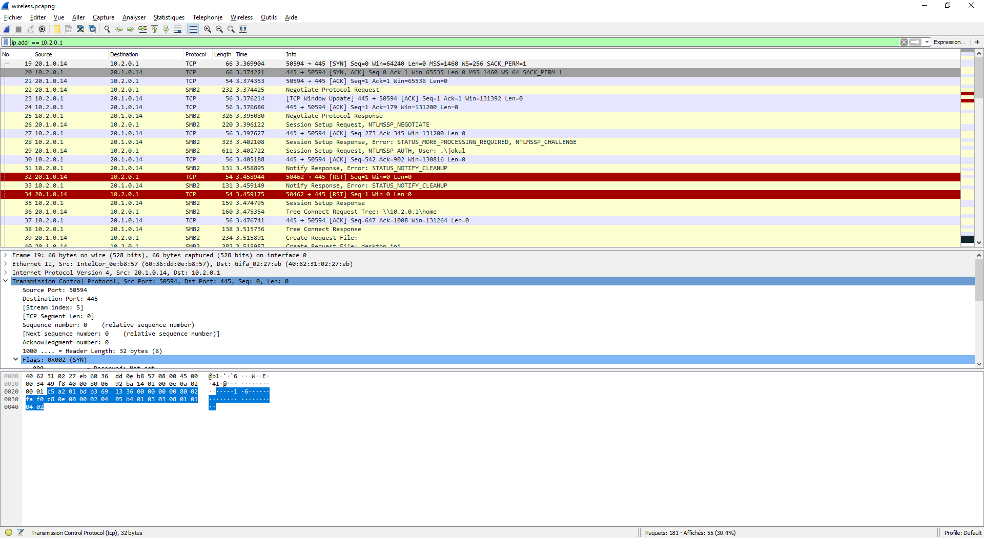

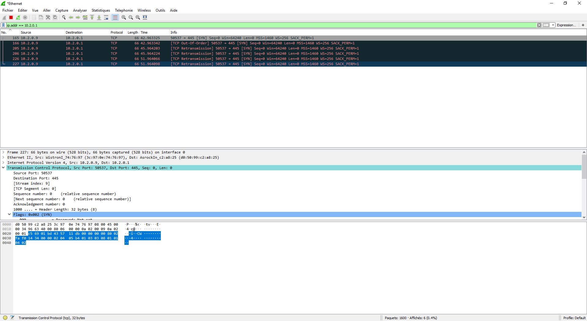

In attachment my wireshark
I'm totally blind about this trouble
