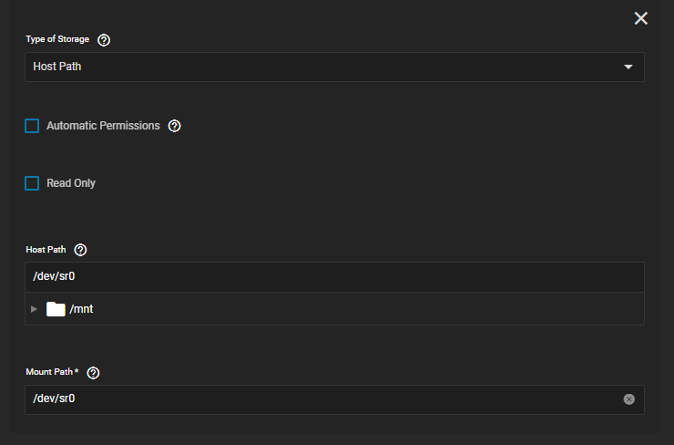

How are you getting this working?
I tried adding my USB Blu-ray drive as `/dev/sr0`:

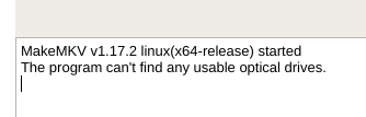

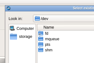

It's not showing up:
It doesn't seem to think I have an optical drive connected:

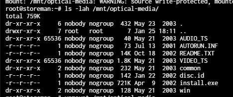

I tried mounting `/dev/sr0` in TrueNAS and saw the correct disk data:

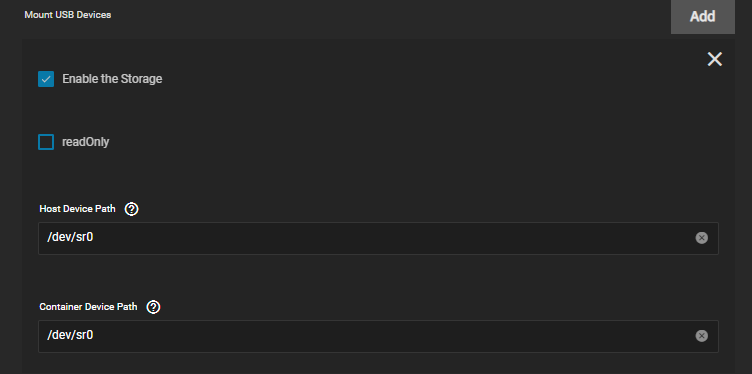

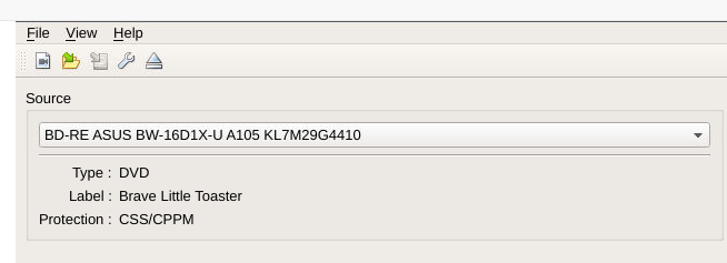

Figured it out:
Not sure how it works for SATA drives, but USB drives require a bit more finesse.
