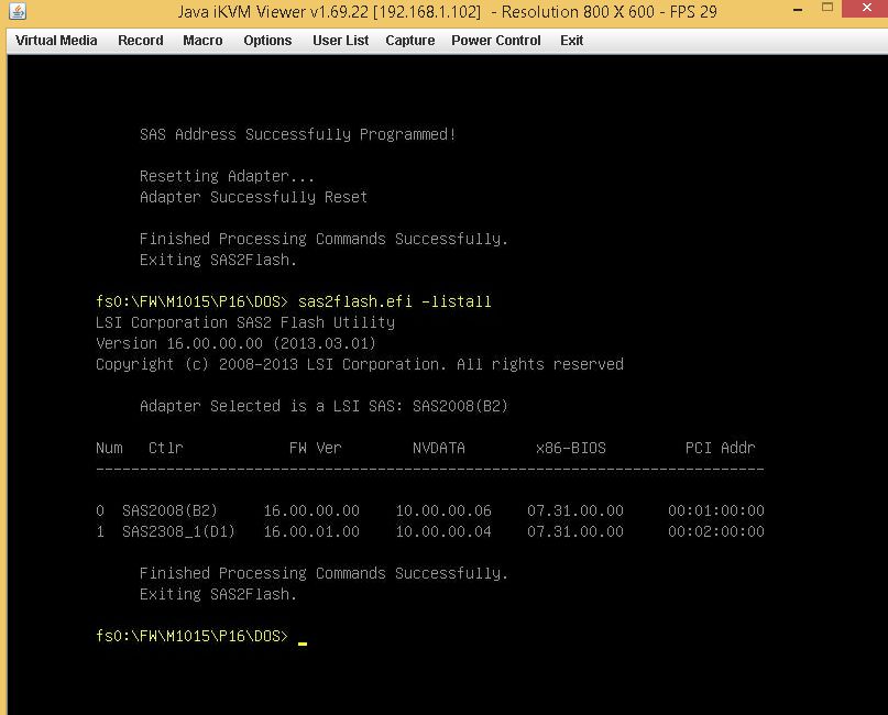

OK, downgraded from p19 to p16. One question though, i could not find the p16.00 for the LSI SAS 2308 that i have on my SM MB. On SM ftp there is only p16.00.01 IT mode; on LSI website i was unable to find model 2308 ...
For the M1015 all OK. See attached picture!
Do you have any idea what fw exactly can i use for 2308 SAS controller?
No more alerts :D
The one on Supermicro's FTP server is almost certainly the right one.
