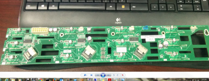

I'd really like to know cause I made a post recently inquiring about the M1015 cards. I have a server with a backplane that has 3 SFF-8087 ports for 12 drives(1 port for 4 drives). However, given that setup, I would require 2 M1015 cards since one card only supports 2 connections.
Now this 9201...it has 4 ports...meaning I would only need to purchase one card AND if it doesnt need to be flashed to work with FreeNAS, that would be a huge blessing. Please let me know!

My Backplane for reference...

The reverse breakout cable would be for the drives being connected directly to the motherboard correct? Because if you take a look at my backplane below, I can only connect SFF-8087 to SFF-8087 on the whichever card I end up getting.
Thank you so much for your advise Eric...truly appreciated!
Right.
